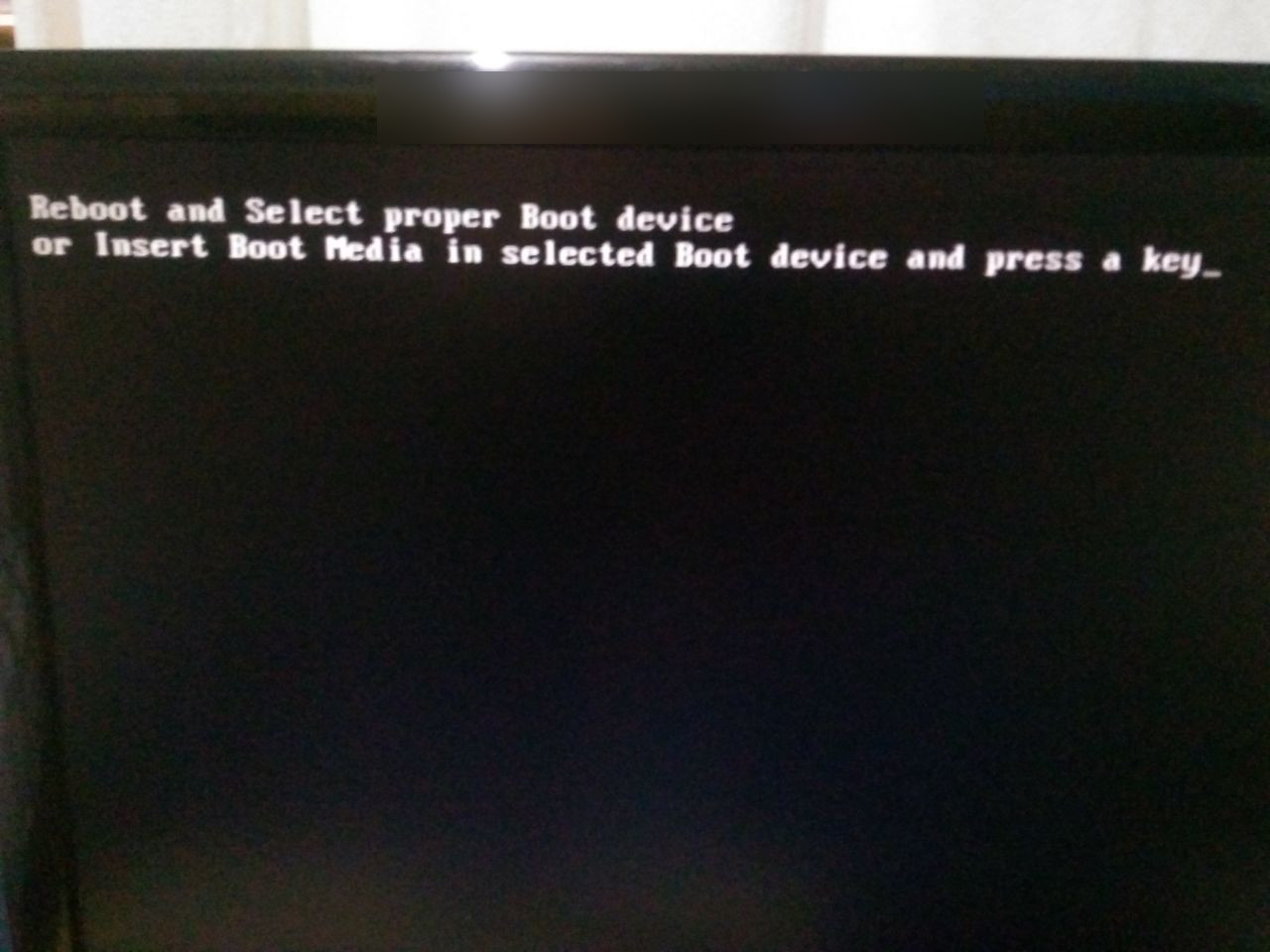

so i have two hds here, i decided to keep one with my main eos install and the other one with w10 format and install eos on it, but when i try to boot it i get an error like “Default boot device Missing or boot failed”, one question, i had chose GPT, should i use MBR instead of gpt for legacy bios like mine ?
Where you choose that? In case the machine is like 10y old Bios only and not able to boot in UEFI mode at all you can use gpt too but with this you can not use automatic partition options in the installer it needs to use manual partition and create a 8MB empty partition flagged as bios-grub… and it is reported to not work in cases…
Most easy will be to use MBR.
here’s a photo of the error, the installations seems to have went well, it asked me to reboot at the end etc, i can see the partition from dolphin

Mixing UEFI boot and MBR boot is known to cause problems in some cases. May depend on the motherboard if it supports booting both.
Post some terminal output:
sudo parted -l
efibootmgr
This may help people who may be able to help to maybe have something to go by.

Also if you say “new PC” why a new PC is still running on Bios? new in case would be at least like not older as 5 years… Bios is not in that devices mainly… they run modern EFI UEFI firmware.
If that it could be simply you set to use legacy Bios CSM mode in the system firmware interface.

so i need to run both commands after loading the Live iso ? i was unsure where to run those commands
efibootmgr will show if you are booted in uefi or Bios(legacy) mode.
sudo parted -l will show information about your partitions/drive
you can post a photo made with smartphone too in case… or use our log pastebin tool withnthe commands to send the output to online pastebin and you can post the url it gives out:
efibootmgr | eos-sendlog
sudo parted -l | eos-sendlog
