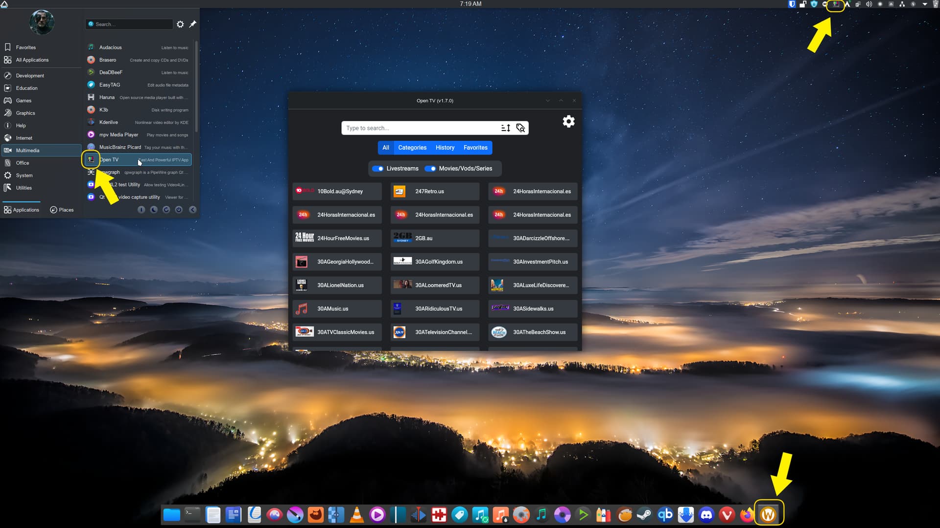

I’m assuming that this is just how it is using Wayland? The app icon for Open TV appears properly in the app menu and the system tray. However, in the icons-only-task-manager it appears as the Wayland icon.

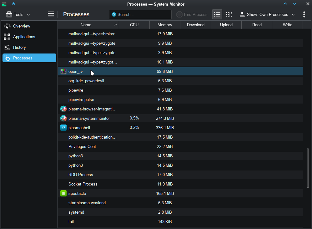

what is the name of the process that the program is running? maybe the process is just identified as wayland :man_shrugging:. I keep telling myself one day I’m going to install something with wayland and try it out but I have yet to do so.

Installed it for checking. Same icon here
Screen_04_06_25_17:07-1

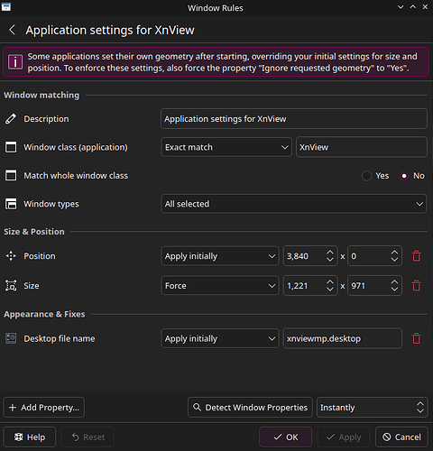

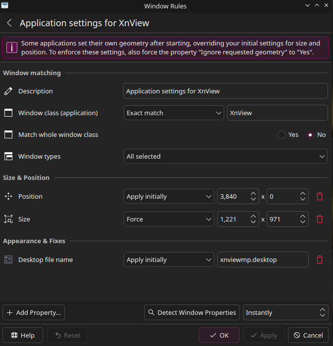

By doing these steps. Essentially linking a window rule to the .desktop file. Of course change the .desktop name tot he one for your program. I know mine is KDE plasma but other DEs must have similar settings somewhere for anyone with different DE.
Open Window rules for application > add property > select “Desktop file name” > add value as “xnviewmp.desktop”
It is the rule at the bottom called “desktop file name” under appearance & fixes, I added that entry.

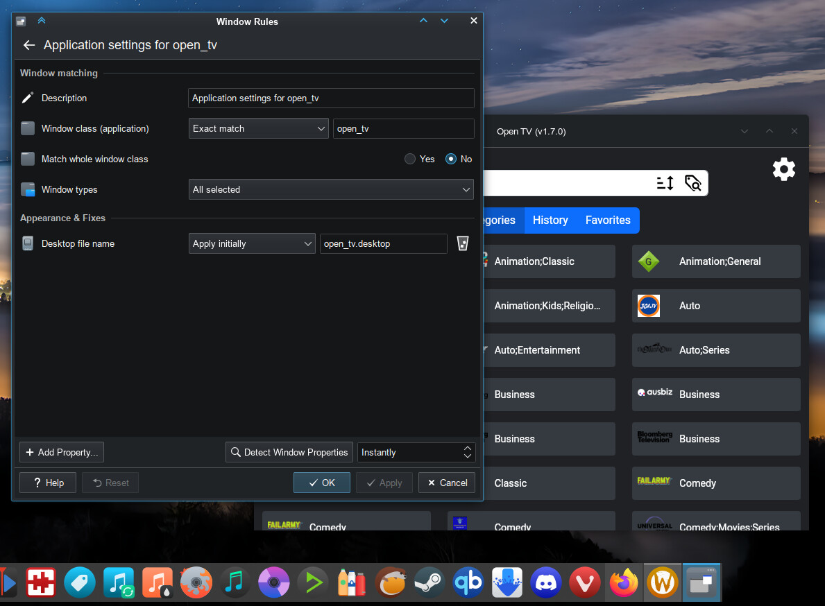

@_Six, I gave it a shot. Added rule, rebooted. Not working, though.
I was hoping that would work. I had the same thing happen to me and put up with the wayland icon for about 9 months after trying everything. And then tried again with this window rule and it worked after a couple hours doing different things, I was almost certain this would work for you.
Only other thing I could think of is changing it’s window rule from ‘apply initially’ to ‘force’.

OpenTV desktop file name (Open TV) does not match resource class name (open_tv), so task manager can not match the icon with window class.
You can rename it
sudo mv /usr/share/applications/Open\ TV.desktop /usr/share/applications/open_tv.desktop
and it should work.
No reboot necessary.
@jake99, @_Six - Thanks, guys. I’m at work at the moment. I’ll look into your suggestions when I get home later this evening.
Yes, Open TV is in both locations as Open TV.desktop rather than open_tv.desktop. So I just deleted the Window Rule and re-did it. Instead of using open_tv for App Initially, I used Open TV. Seems to have worked fine.

Thanks for the instructions. That’s how it works for me too. I misunderstood your first post. I was only looking at the systray and not the taskbar. It wasn’t until the second time I looked, today, after reading through the topic again, that I noticed the same error :vulcan_salute:
Screen_05_06_25_16:59
