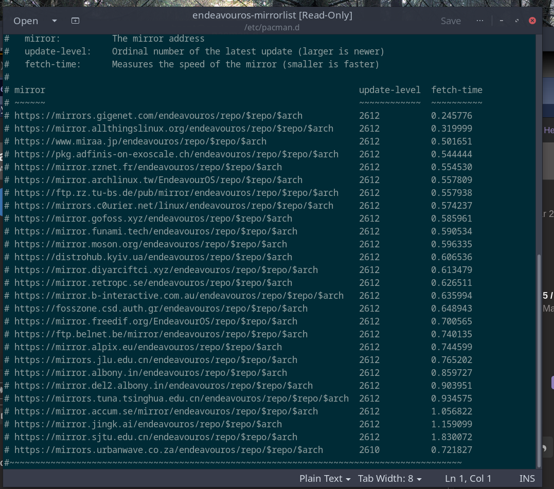

#Mirror ranking info at (UTC) 03/22/2026 07:41:22 PM:
The following fields are shown for each mirror:
#mirror: The mirror address
#update-level: Ordinal number of the latest update (larger is newer)
#fetch-time: Measures the speed of the mirror (smaller is faster)
#mirror update-level fetch-time
#https://mirrors.gigenet.com/endeavouros/repo/$repo/$arch 2612 0.307338
#https://mirror.allthingslinux.org/endeavouros/repo/$repo/$arch 2612 0.479441
#https://mirror.diyarciftci.xyz/endeavouros/repo/$repo/$arch 2612 0.603011
#https://mirror.moson.org/endeavouros/repo/$repo/$arch 2612 0.635560
#https://mirror.funami.tech/endeavouros/repo/$repo/$arch 2612 0.695082
#https://mirror.gofoss.xyz/endeavouros/repo/$repo/$arch 2612 0.707264
#https://pkg.adfinis-on-exoscale.ch/endeavouros/repo/$repo/$arch 2612 0.737798
#https://mirror.rznet.fr/endeavouros/repo/$repo/$arch 2612 0.746995
#https://mirror.b-interactive.com.au/endeavouros/repo/$repo/$arch 2612 0.762538
#https://distrohub.kyiv.ua/endeavouros/repo/$repo/$arch 2612 0.770534
#https://mirror.alpix.eu/endeavouros/repo/$repo/$arch 2612 0.798604
#https://mirrors.jlu.edu.cn/endeavouros/repo/$repo/$arch 2612 0.806928
#https://mirrors.c0urier.net/linux/endeavouros/repo/$repo/$arch 2612 0.865270
#https://mirror.jingk.ai/endeavouros/repo/$repo/$arch 2612 0.869877
#https://mirror.archlinux.tw/EndeavourOS/repo/$repo/$arch 2612 0.885167
#https://www.miraa.jp/endeavouros/repo/$repo/$arch 2612 0.933778
#https://mirror.freedif.org/EndeavourOS/repo/$repo/$arch 2612 0.969306
#https://mirror.accum.se/mirror/endeavouros/repo/$repo/$arch 2612 1.109181
#https://fosszone.csd.auth.gr/endeavouros/repo/$repo/$arch 2612 1.112821
#https://mirror.albony.in/endeavouros/repo/$repo/$arch 2612 1.247852
#https://mirrors.tuna.tsinghua.edu.cn/endeavouros/repo/$repo/$arch 2612 1.268353
#https://ftp.belnet.be/mirror/endeavouros/repo/$repo/$arch 2612 1.275314
#https://mirror.retropc.se/endeavouros/repo/$repo/$arch 2612 1.331492
#https://ftp.rz.tu-bs.de/pub/mirror/endeavouros/repo/$repo/$arch 2612 1.603065
#https://mirror.del2.albony.in/endeavouros/repo/$repo/$arch 2612 2.339592
#https://mirror.sjtu.edu.cn/endeavouros/repo/$repo/$arch 2612 3.519991
#https://mirrors.urbanwave.co.za/endeavouros/repo/$repo/$arch 2610 0.841100
#Original mirrorlist before ranking:
#EndeavourOS Repository Mirrorlist
#Entry in file /etc/pacman.conf:
#[endeavouros]
#SigLevel = PackageRequired
#Include = /etc/pacman.d/endeavouros-mirrorlist
Tip: Use the ‘eos-rankmirrors’ program to rank
these mirrors or re-order them manually.

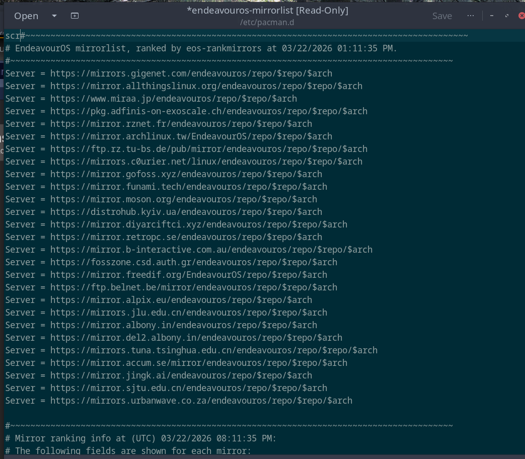

my point? lotsa #’s….was I supposed to uncomment something after my new install?
The output shows no active mirrors.

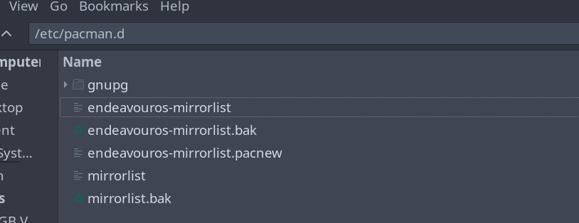

Did you by any chance overwrite the mirrorlist with the pacnew list ? Because I have noticed when you do that the servers on the list will have a # in front of them.

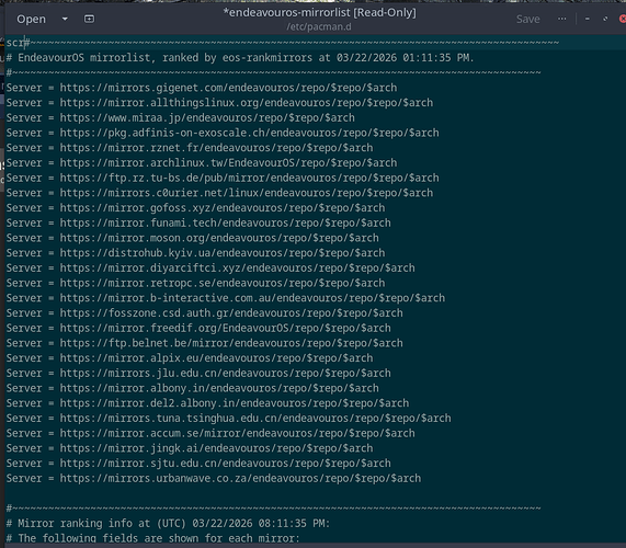

Can you now show your latest endeavouros-mirrorlist?
For better readability, please copy the list between two lines of 3 backticks (```), for example
All contents here
between the backtick lines!
What I meant was the “Arch” mirrorlist not the endeavouros-mirrorlist to avoid any confusion.
Exactly. Much easier to read. @drunkenvicar, then,your above post would look like this…
#[endeavouros]
Australia
#Server = https://mirror.b-interactive.com.au/endeavouros/repo/$repo/$arch
Belgium
#Server = https://ftp.belnet.be/mirror/endeavouros/repo/$repo/$arch
Canada
#Server = https://mirror.allthingslinux.org/endeavouros/repo/$repo/$arch
China
#Server = https://mirrors.tuna.tsinghua.edu.cn/endeavouros/repo/$repo/$arch
#Server = https://mirrors.jlu.edu.cn/endeavouros/repo/$repo/$arch
#Server = https://mirror.sjtu.edu.cn/endeavouros/repo/$repo/$arch
Denmark
#Server = https://mirrors.c0urier.net/linux/endeavouros/repo/$repo/$arch
France
#Server = https://mirror.rznet.fr/endeavouros/repo/$repo/$arch
Germany
#Server = https://mirror.alpix.eu/endeavouros/repo/$repo/$arch
#Server = https://mirror.moson.org/endeavouros/repo/$repo/$arch
#Server = https://ftp.rz.tu-bs.de/pub/mirror/endeavouros/repo/$repo/$arch
#Server = https://de.repo.c48.uk/endeavouros/repo/$repo/$arch
#Server = https://mirror.diyarciftci.xyz/endeavouros/repo/$repo/$arch
Greece
#Server = https://fosszone.csd.auth.gr/endeavouros/repo/$repo/$arch
India
#Server = https://mirror.albony.in/endeavouros/repo/$repo/$arch
#Server = https://mirror.del2.albony.in/endeavouros/repo/$repo/$arch
#Server = https://mirrors.nxtgen.com/endeavouros-mirror/repo/$repo/$arch
Japan
#Server = https://www.miraa.jp/endeavouros/repo/$repo/$arch
Singapore
#Server = https://mirror.jingk.ai/endeavouros/repo/$repo/$arch
#Server = https://mirror.freedif.org/EndeavourOS/repo/$repo/$arch
South Africa
#Server = https://mirrors.urbanwave.co.za/endeavouros/repo/$repo/$arch
South Korea
#Server = https://mirror.funami.tech/endeavouros/repo/$repo/$arch
Sweden
#Server = https://mirror.accum.se/mirror/endeavouros/repo/$repo/$arch
#Server = https://mirror.retropc.se/endeavouros/repo/$repo/$arch
Switzerland
#Server = https://mirror.gofoss.xyz/endeavouros/repo/$repo/$arch
#Server = https://pkg.adfinis-on-exoscale.ch/endeavouros/repo/$repo/$arch
Yes, and the mirrorlist is corrupt for an unknown reason.
I have to take formatting class it was just as putrid with back ticks as it was with no ticks at all
top half:
bottom half:
That looks very much OK now!

contents of folder if it helps
