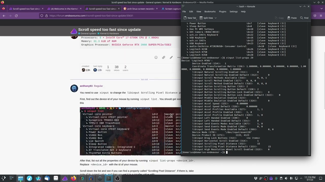

You need to use xinput to change the libinput Scrolling Pixel Distance property.
First, find out the device id of your mouse by running xinput list. You should get something like this
After that, list out all the properties of your device by running xinput list-props <device_id>. Replace <device_id> with the id of your mouse.
Scroll down the list and see if you can find a property called “Scrolling Pixel Distance”. If there is, take note of its current value, and then you set it to a smaller value with:
# 10 is just a dummy value. Pick a number that is smaller than your current setting
xinput --set-prop "libinput Scrolling Pixel Distance" 10
Test out your mouse. If you’re happy with it and want to make the setting permanent, just add the command to a script to be launched at startup.
Hope this helps.
Thanks for the help. I tried adjusting the settings for my Logitech M705 using “libinput Scrolling Pixel Distance”, I tried changing the value up and down, I tried a couple other settings too, even tried settings on other devices that were similarly named, but nothing ever changed the scroll speed.
