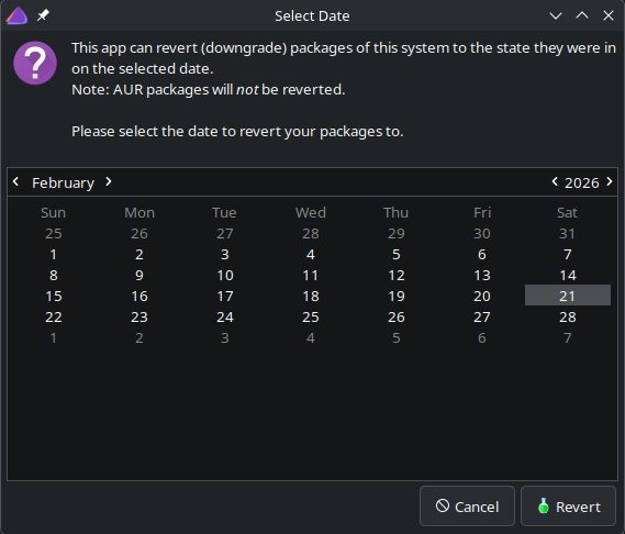

I’m not sure what was in the last updates that would have affected it. If you wanted you could revert back to before you updated using eos-shifttime
You can try?
and how i do this ? (edit first try rebbot)
Just use the command
eos-shifttime
Then select the date that is right before you updated.
in the beginning i kept track off every update but not anymore… so not sure off the date is this impotant ? (edit reboot did not work)
Well i have no idea what update caused the issue. I was hoping it was the last time you updated?
