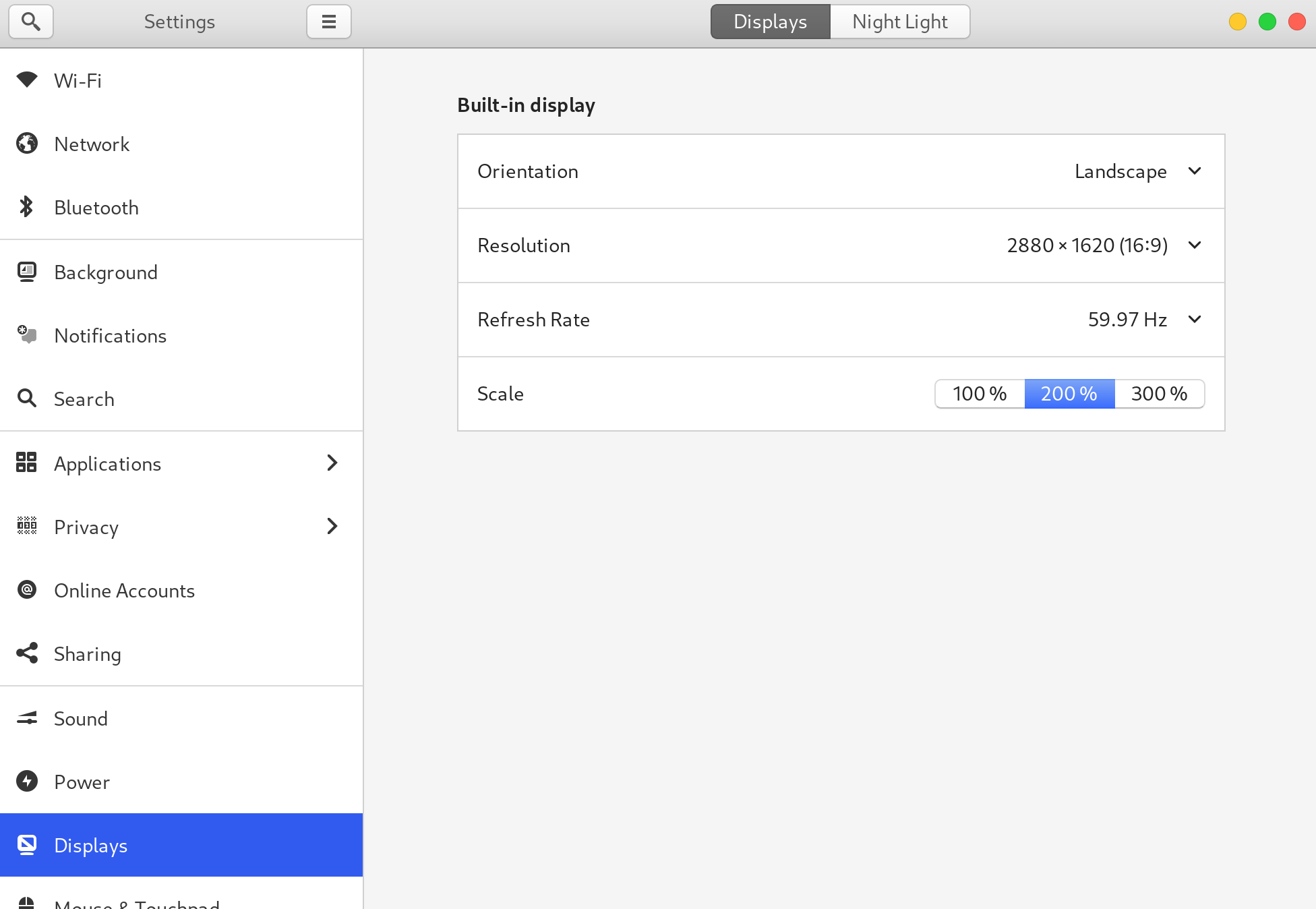

I just installed (as of last night) and am having issues with my screen resolution. I am having trouble with scaling. Whenever I restart or log back in after being logged out the screen is all messed up and only showing on a quarter of the screen. I have to manually change it back in the settings every time. Is this because I have a 4k screen? Any help for this or is Endeavor not going to work out for me? I’m a newbie, just switched from Solus because the battery life was still bad for me.

No the font is fine, its just that when I log back in or restart the screen is all messed up. Everything is either super tiny, or only showing up in the top left quarter of the screen and everything else is black. I believe it is hidpi? I bought it refurbished on ebay so I’m not 100% sure, its the infinity edge touch display, 4K. So I’m assuming so. Any help is appreciated. Thanks for everything so far.

As a heads up, you don’t seem to be running at 4K, you seem to be running at 1440p. Have you tried settings the resolution to 4K?
Have you tried the LTS kernel to see if it is something specific with the drivers? I know that i915 drivers have been a bit weird lately.

Sorry for the poor resolution photos, I was having trouble. Hopefully this helps illustrate my problem better, its only showing up a quarter of the screen. I was even having trouble with Solus when I first installed on this laptop, so I’m starting to wonder if its something wrong with the video driver or graphics card like you said… I’m still stumbling in the dark here. I just got this new laptop, for the express purpose of installing Linux, and now all of these roadblocks. lol oh well, it’s all a learning experience. How do I change the settings to 4K? I went into settings and tried to fiddle with the resolution, but its still hit or miss…
it displayed fine, but it was very tiny and hard to see, so I had to mess with the resolution to get it bigger. Certain apps still display very tiny for me. Steam in particular.
I put the resolution all the way as high as I had settings for in Budgie. Which turned out to be 3840x2160 and then I scaled up to 200% but it still seems a bit small to my eyes. If I go to 300% its too big, i wish I could set it to 250% but there’s no option.
Edit: when I log out or restart it still only shows in the top left quarter of the screen.
