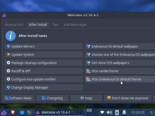

Screenshot_2021-03-18_10-20-25
this is how the xfce starts up , correct it whit arandr but after boot , the same problems
