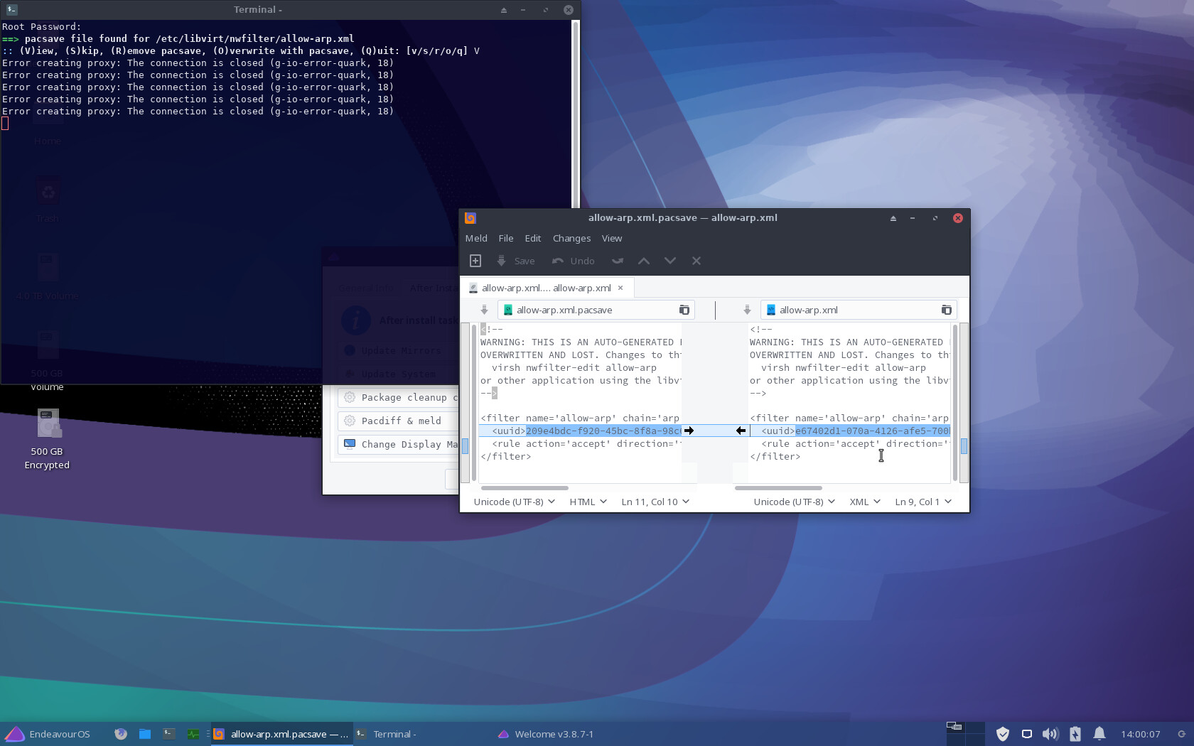

Okay so is working but is this correct?
Screenshot_2020-12-11_14-00-15
Edit: My problem is i don’t know how it is supposed to work? If i close the meld screen then the terminal gives me the options to close etc. I was just wondering about the error messages.
Those error messages on the terminal should not cause any real problems, so they can be ignored.
You could test the pacdiff program directly from the terminal (i.e. without Welcome). Then you’ll see what pacdiff assumes. It is a traditional CLI program, and for me initially it seemed a bit clumsy, but it works.
