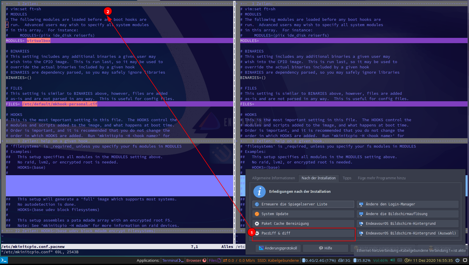

I would say vim is too nerdy for most users to edit diff files?
I think vim would cause its own set of issues for a lot of users. :laughing:
for me too I do not use vim at all, it is too nerdy for me, I have lost enough brain on reminding all my i3
keybindings :rofl:
2020-12-11_16-56
but indeed it is looking nice :mechanical_arm:
Note that using this new Pacdiff button may require manual intervention.
As the pacman update output shows, one must copy the new EOS_WELCOME_PACDIFFERS setting
  EOS_WELCOME_PACDIFFERS=(kdiff3 kompare diffuse meld diff)
from file
  /etc/eos-script-lib-yad.conf.pacnew
to
Note that you can (of course) modify the order of the diffing programs in the variable. The first one found will be used as the diffing program in pacdiff.
Edit: fixed file path.
Does this require one to have vim installed?
==> ERROR: Cannot find the vim -d binary required for viewing differences.
Edit: Also don’t understand the manual intervention.
Note: “vim -d” is actually not supported by Welcome here.
Manual intervention means: if you want to use this Welcome’s new Pacdiff button, you should copy related configuration into your existing configuration file, as explained in my previous post.
If you don’t want to use it, then you don’t have to do any manual intervention.
I don’t see this file.
i do not have this file at all
