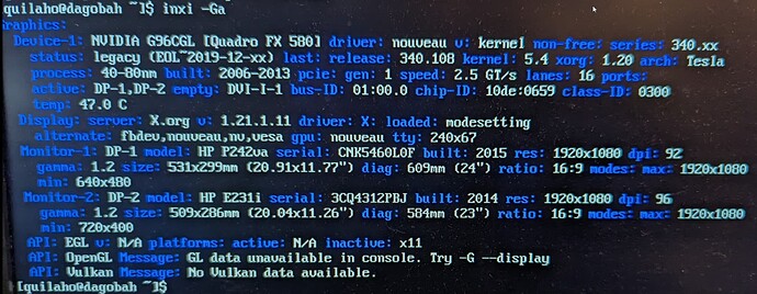

I’ve built an EOS box out of an older workstation class machine. After installing and configuring, I went to install the NVidia drivers. I followed the instructions at the NVidia Arch Wiki identifying my Quadro FX 580 as needing the nvidia-340xx drivers and installed them. Well, after reboot, the boot sequence got as far as ‘Reach target Graphical Interface’ and then nothing but a black screen.
I got to a command line with control-alt-f3, removed the package and rebooted. I still have nothing but a black screen.
I reinstalled the mesa package (which research indicated contained the nouveau driver) just to see if it would help. It did not.
`lsmod | grep nouveau’
shows the nouveau driver is loaded.
What do I try next to recover my graphical environment?
A sudo rmmod nouveau tells me “module is in use”. Granted, I’m stabbing in the dark. If there is a more definitive way to know that a module is loaded, I’m all ears.

I thought maybe you had reinstalled. I was just asking how you installed Nvidia and by that i meant what commands exactly because i wondered if you didn’t install all the packages needed. Unfortunately Nvidia doesn’t support these drivers. That is why they are packaged in the AUR.
I think you also need to install nvidia-340xx-utils. Not sure it installs this? Then there is also nvidia-340xx-settings and lib32-nvidia-340xx-utils if needed.

I tried to follow the NVidia Arch Wiki page as much as possible. It pointed to using the NVidia site to determine the needed driver version. According to it, 340.108 is the version I needed.

I seem to have had the correct driver but, I did not initially use the DKMS nor did I install the utils package. The lib package is installed as a dependency.
