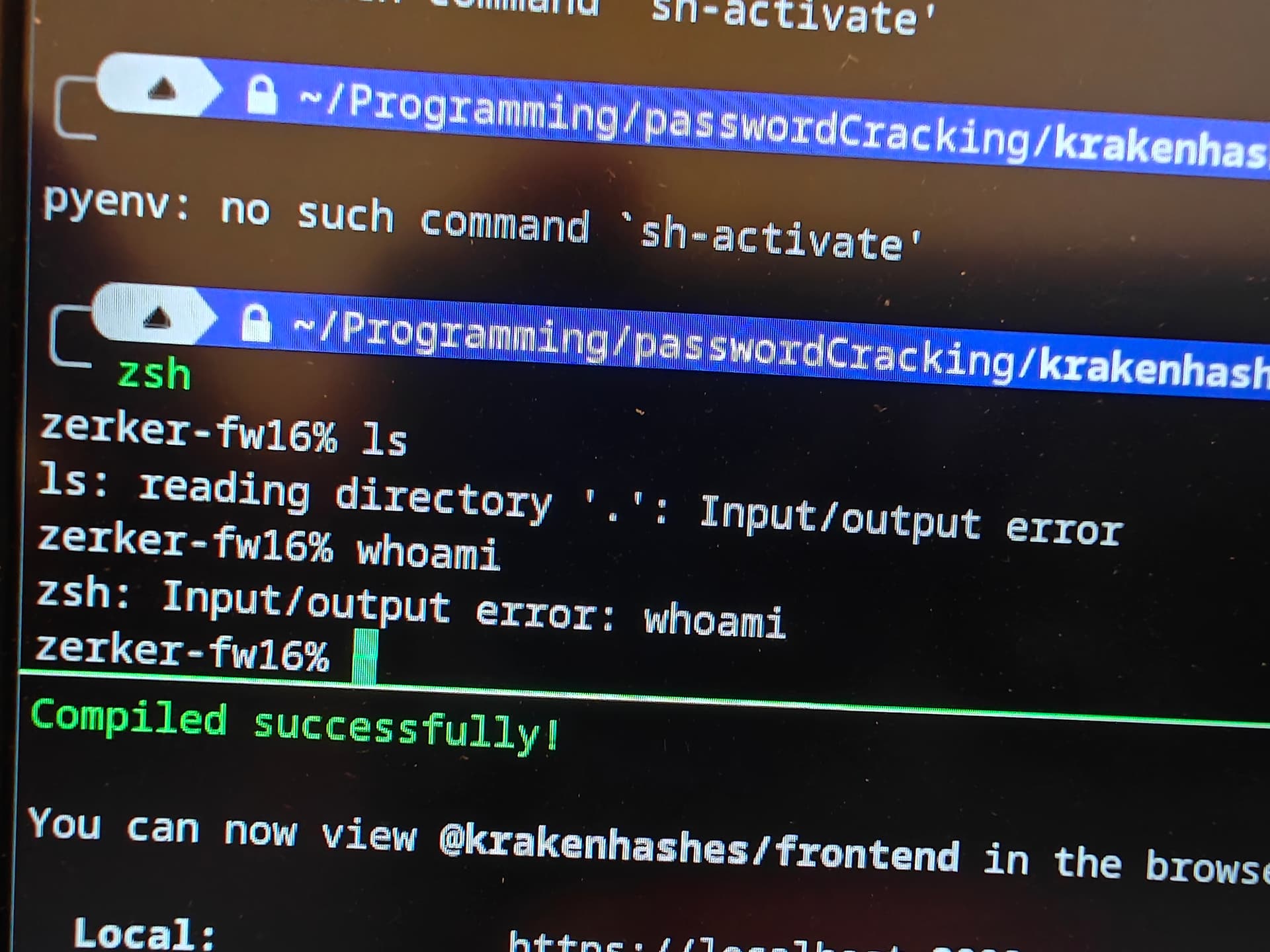

So it crashed my entire system in about 3 minutes…
I can’t interact with anything so I had to snap a photo.
Such programs can use a huge amount of memory so OOM could definitely be the cause of your problems.
So, as suggest already by others, set some swap, type doesn’t matter, swap file, partition or zswap. 8GB should be enough, so the system has some room when needed.
I got that but I’m not running the model locally and have 96GB of RAM. When in cursor I’m watching the system monitor and htop and both show ram in use at less than 10GB. I never see it go above and there are no OOM errors.
Not Cursor, now it is happening almost as soon as I boot up.

Got to be hardware. Try 16gb then 32gb etc, also is your SSD OK?
