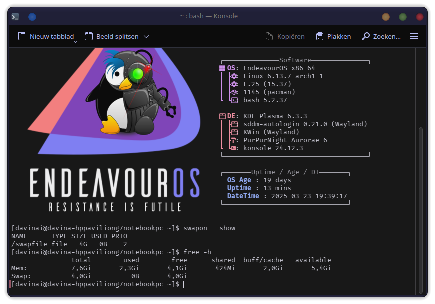

So i guess i added a swapfile now correct ? followed the arch tutorial. Between a swap file and swap partition there is no difference.
From that screenshot it looks like you have 4gb of swap.

I just added it to test, my system already was stable without swap
