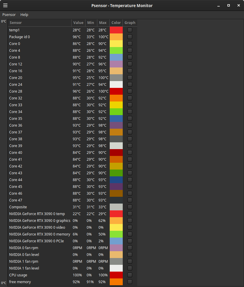

Here is a screenshot of psensor while on test 11…
Hottest temps I have seen but should be par for the course on this cpu. Surprising I didn’t crash, however the computer has never been under load when previous crashes have occured.

To me mprime shows high temp (too high for normal use but i9 are hot headed) but it didn’t reboot as you say so basic hardware seems to be fine
