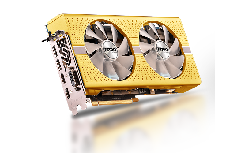

Yes …Sapphire RX 590 Gold Edition
RX590_NITRO_plus_AMD50_8GBGDDR5_2DP_2HDMI_DVI_C03_800x500
