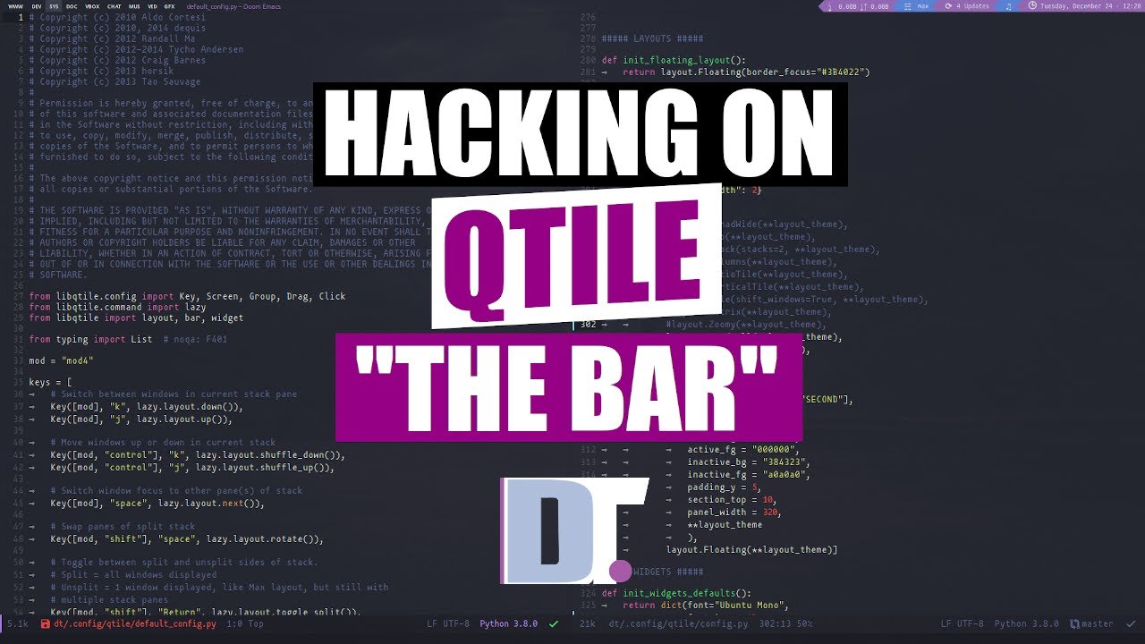

DT has quite few videos, in case, to introduce qtile
