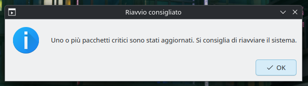

Thanks for the reply! I have an AMD graphics card (and CPU), so I need AMD (open) drivers. Could these be added to those scripts, or are those enough?
I think I was able to make something wrong. :thinking: :rofl:
Last updated in this, he did not perform the script because he had something missing (I forgot to mark the error). At the next important update I will mark the mistake that gives me.
Meanwhile, let’s see if the rest is correct. This is the reboot-recommeded.hook file:

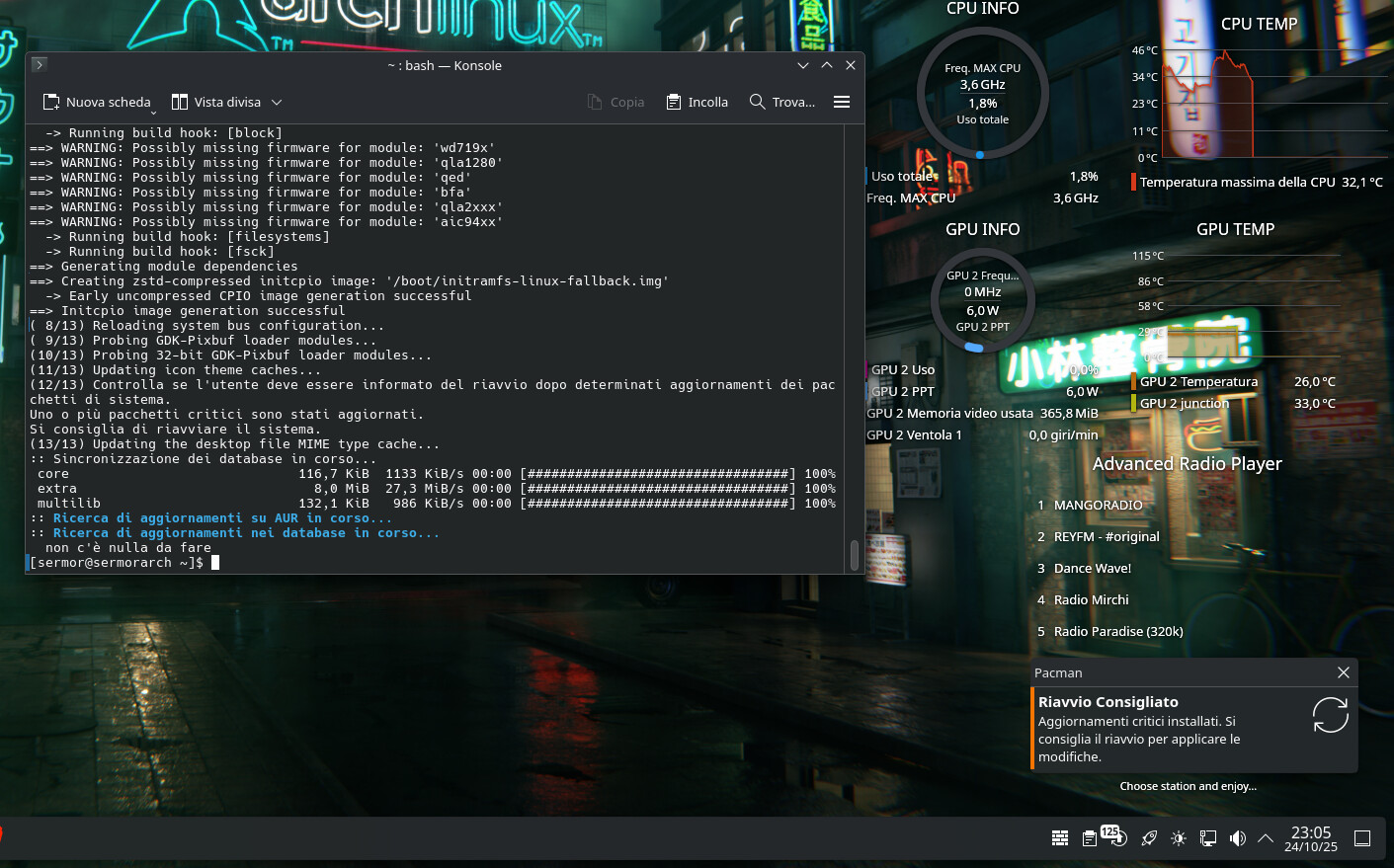

Mmmhhh, it seems to work instead! Then maybe I read badly the first time.
(4/5) Controlla se l’utente deve essere informato del riavvio dopo determinati aggiornamenti dei pacchetti di sistema.
Uno o più pacchetti critici sono stati aggiornati.
Si consiglia di riavviare il sistema.
This is the complete log of the update:

Thanks again!
I finally managed to add a graphic notification too.
I added this line to the check-reboot-recommended file:
#!/bin/bash
# Messaggio per il terminale
echo "Uno o più pacchetti critici sono stati aggiornati."
echo "Si consiglia di riavviare il sistema."
# Notifica grafica con kdialog
kdialog --title "Riavvio consigliato" --msgbox "Uno o più pacchetti critici sono stati aggiornati. Si consiglia di riavviare il sistema."
I think it can be changed again, to make it a popup with a countdown for example, or change the style and position of the notification window. But for now I am satisfied like this.
Using AI, I managed to change things a bit, and now the warning is more consistent.
This is what the check-reboot-recommended file looks like now:
#!/bin/bash
# Cerca l'utente loggato per mostrargli la notifica
USER_NAME=$(who | grep -E 'tty[0-9]+|:[0-9]+' | awk '{print $1}' | sort -u | head -n 1)
if [ -n "$USER_NAME" ]; then
    USER_ID=$(id -u "$USER_NAME")
    DBUS_ADDRESS="unix:path=/run/user/$USER_ID/bus"
    # Comando per la notifica standard
    sudo -u "$USER_NAME" DISPLAY=:0 DBUS_SESSION_BUS_ADDRESS="$DBUS_ADDRESS" \
    notify-send --app-name="Pacman" --urgency=critical --icon=system-reboot \
    "Riavvio Consigliato" "Aggiornamenti critici installati. Si consiglia il riavvio per applicare le modifiche."
fi
And this is what it looks like on desktop:
I’d say I’m satisfied with the result. Every now and then it gets something right (but you have to be careful, the AI ​​often gets it wrong).
