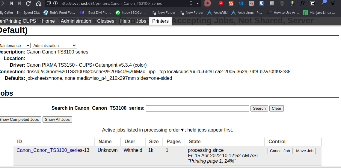

Installed the cups-bjnp and added the printer in CUPS interface.
Screenshot from 2022-04-15 12-33-47
Not sure if it’s important, but there is an iMac on the network running CUPS (they created CUPS of course :thinking: but our one is a fork of it) so it correctly identifies the printer as being on @iMac. I’m wondering since the CUPS server is running on iMac, this could be a network problem, as it printed before on the same home network. The print spooler on the mac is empty.
Here are the CUPS pages.
then it times out without printing.

It finally worked, but I thought it was worth some explanation, so members benefit from the topic in future.
It did not work with IPP, but it worked with Canon driverless.
I was not so stressed to get the printer working as I was still able to print from the iMac wirelessly, or at least so I thought. Wife informed me she could no longer print from the iMac. It was unlikely to a problem with two computers, so I reset the Canon printer to defaults, and voila! I was printing from the iMac.
I opened up CUPS on the :enos: and a new driver appeared in the CUPS driver list: Canon TS3100 series, driverless, cups-filters. All I had appearing were CUPS-Braille and CUPS-PDF. So it ends well and the advice on this post works, Thank you Rick.
