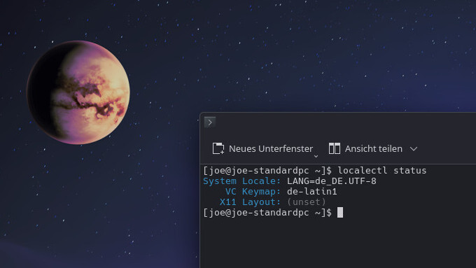

Due to a change introduced in the xkeyboard-config major upgrade (version 2.48-1), the X11 keyboard layout configuration managed by systemd-localed may be unset post-upgrade. This occurs because systemd-localed reads the XKB model, layout, variant, and options directly from /etc/vconsole.conf. If only the legacy Xorg keyboard snippet exists, localectl reports the X11 layout as unset. In many Desktops this will show by issue that keyboard output is screwed..Y=Z no Umlauts (Germans) or you get issue in case your passwort uses such letters uneven with default locale-C layout.
Check at your install with:
localectl status
If you see X11 Layout: (unset) fix it by running:

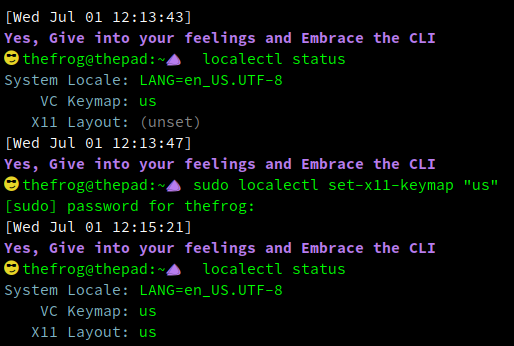

sudo localectl --no-convert set-x11-keymap "your-language-keymap"
Note: Replace "your-language-keymap" with your specific layout (e.g., de, us).

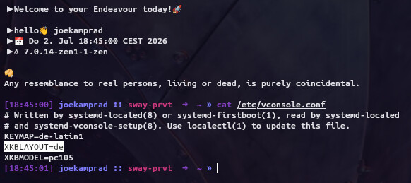

This command writes the selected XKB state alongside KEYMAP into /etc/vconsole.conf and replaces any stale XKB entries, matching the standard systemd behavior.
Simpler said.. it adds missing values for XKBLAYOUT=XX
and XKBMODEL=XXXX to /etc/vconsole.conf :wink:

still in this case someone using en_us keyboard would not notice.

cat /etc/vconsole.conf needs one or two extra entries to be able to set the values needed ..
The nifty little features I always loved X11/Xorg for… :wink:
$ cat /etc/vconsole.conf
# Written by systemd-localed(8) or systemd-firstboot(1), read by systemd-localed
# and systemd-vconsole-setup(8). Use localectl(1) to update this file.
KEYMAP=de-latin1
XKBLAYOUT=de
XKBMODEL=pc105
XKBVARIANT=e2
XKBOPTIONS=lv5:lsgt_switch,compose:caps,keypad:future,nbsp:level2,terminate:ctrl_alt_bksp,grp:win_space_toggle
