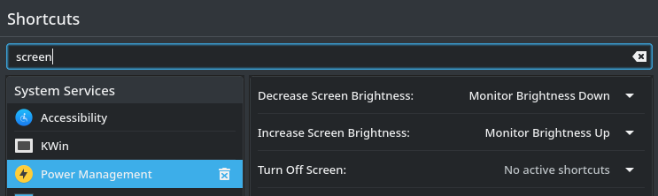

What about keeping monitor power on but using kwin screen switching off function? You can manually set a keyboard shortcut for this, I don’t think it has one by default.
2022-01-25-off
