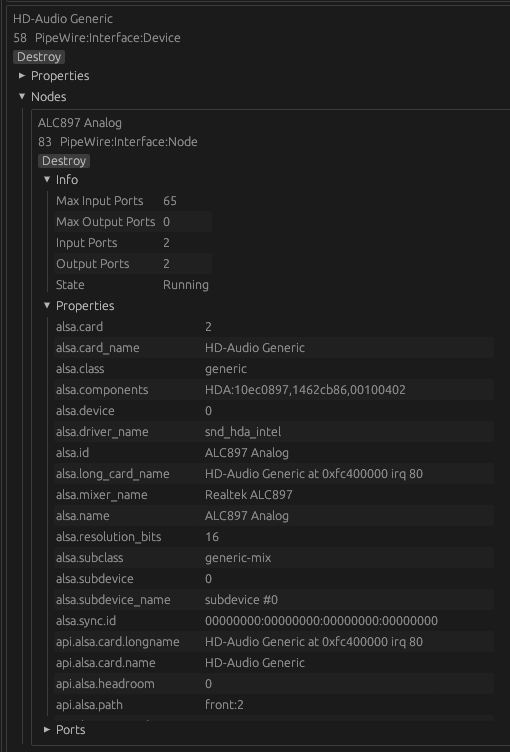

installed and had a look, confirms the information i got from the commands, the pipewire source for my media player is 32 bit float, and even the output on my analog device it says 32 bit float, but the properties of the analog module itself still says alsa resolution bits at 16, everything online seems to point to alsa.resolution_bits being the bit depth value, and also even though the mode is S32_LE (signed 32 bit little endian) now its saying its actually float? fully aware this is probably not the easiest problem to solve like this but yknow figured id try everything just to see, ive added a screenshot of where exactly i think the problem is, everything else either lacks any mention of bit depth or is set at 32 already, only here is there resolution bits and its at 16
ah i see now, i suppose the only foolproof way around this would be getting an external DAC and hoping alsa plays better with it, at least as far as i know, still i feel bad for anyone who wants to do this for editing purposes it seems like a headache lol

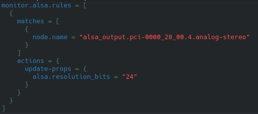

for the solution part i will share how i raised my bit depth, first i needed the alsa ID for my actual audio thing, which you can find doing pactl list sinks and scrolling until you find the audio your using, for me its Starship/Matisse HD Audio Controller Analog Stereo so i found that, the alsa ID part will be under Name: part at the top, then you navigate to the /usr/share/wireplumber/wireplumber.conf.d folder, i made a .conf file there called 83-alsa.conf sudo touch 83-alsa.conf because 83 was the numerical ID at the time but this changed after restart it seems so i guess you can put any number there, anyways in the screenshot below is what you put in there, except where it says node.name thats where you put your alsa ID from earlier and then just save it, and reboot and it should have the value changed to 24 bits (according to what it tells me).
grain of salt with this i got this off another arch linux forum post and couldnt tell you anything about it outside of that
