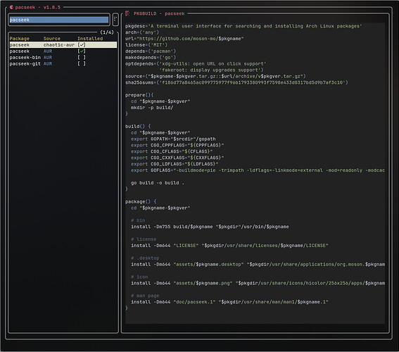

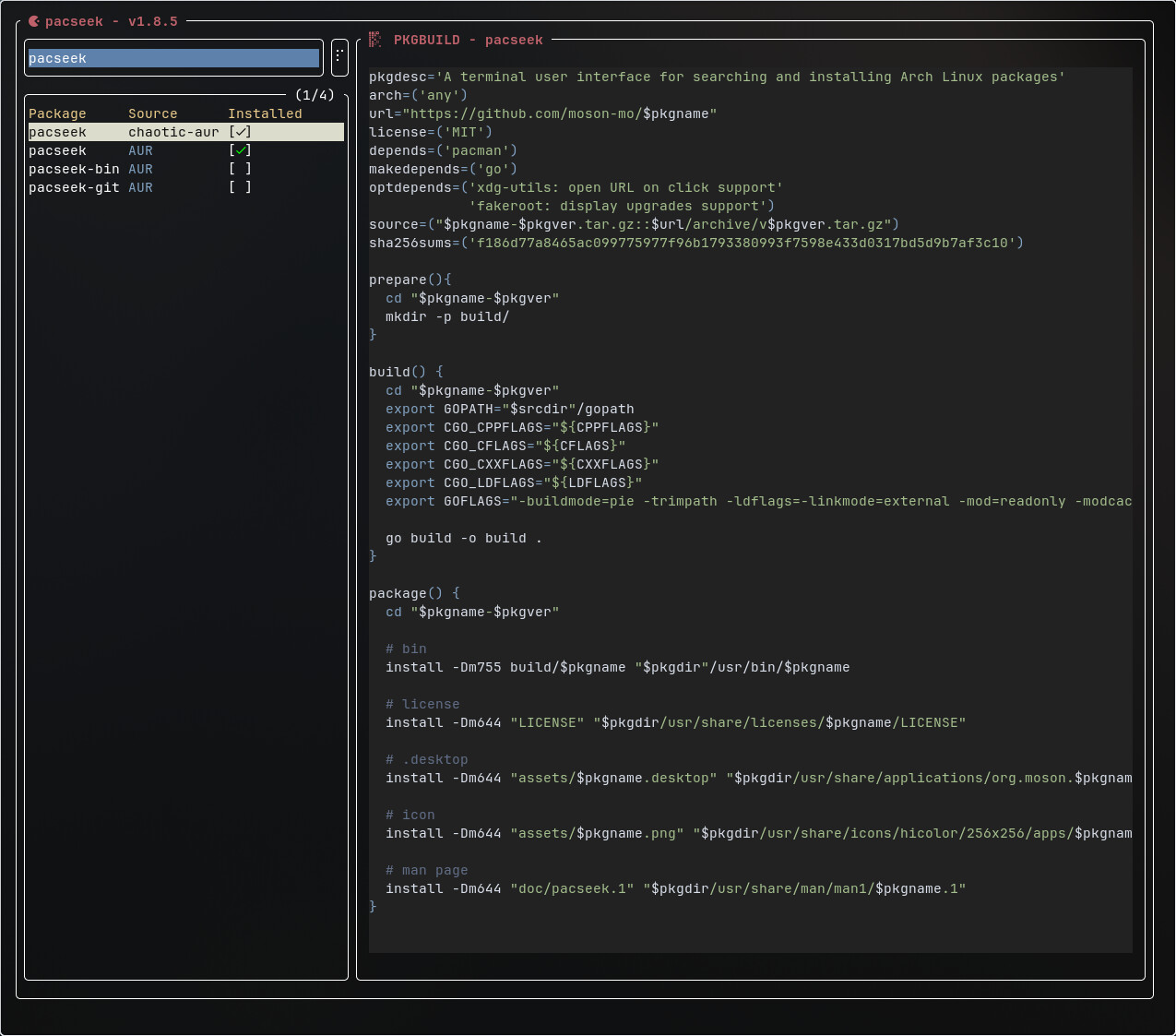

Speaking of Pacseek and reviewing PKGBUILDs, you can review the PKGBUILD for any package from within Pacseek itself by pressing Ctrl+P.
You can also press Ctrl+O to visit whatever URL is listed for the package. A very handy tool for reviewing packages! :smiling_face_with_sunglasses:
