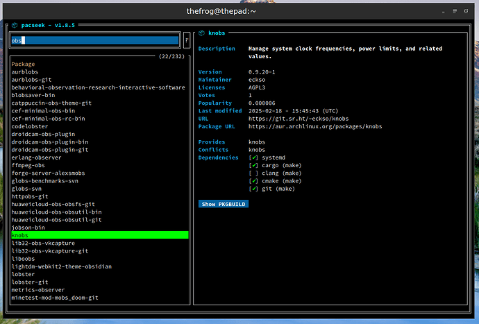

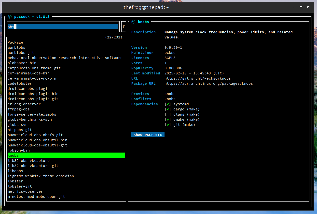

Yes
I get this with pacseek

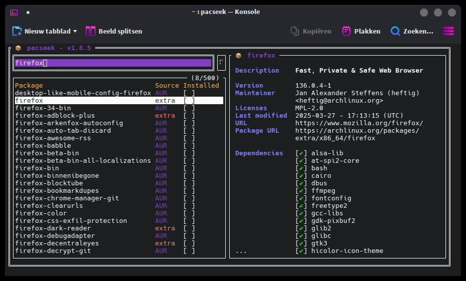

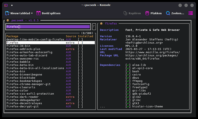

You understood it correctly to search for packages you can use yay e.g. firefox like this
yay firefox
That will give you a numbered list of packages.
Or if you want only search if a package is available you can use (same example)
yay -Ss firefox
The only disadvantage of this method is you can end up with a long list of packages that makes it
hard to choose from.
this is a screenshot of the same search on pacseek
BTW this is only a part of the result scrolling down gives more results.
