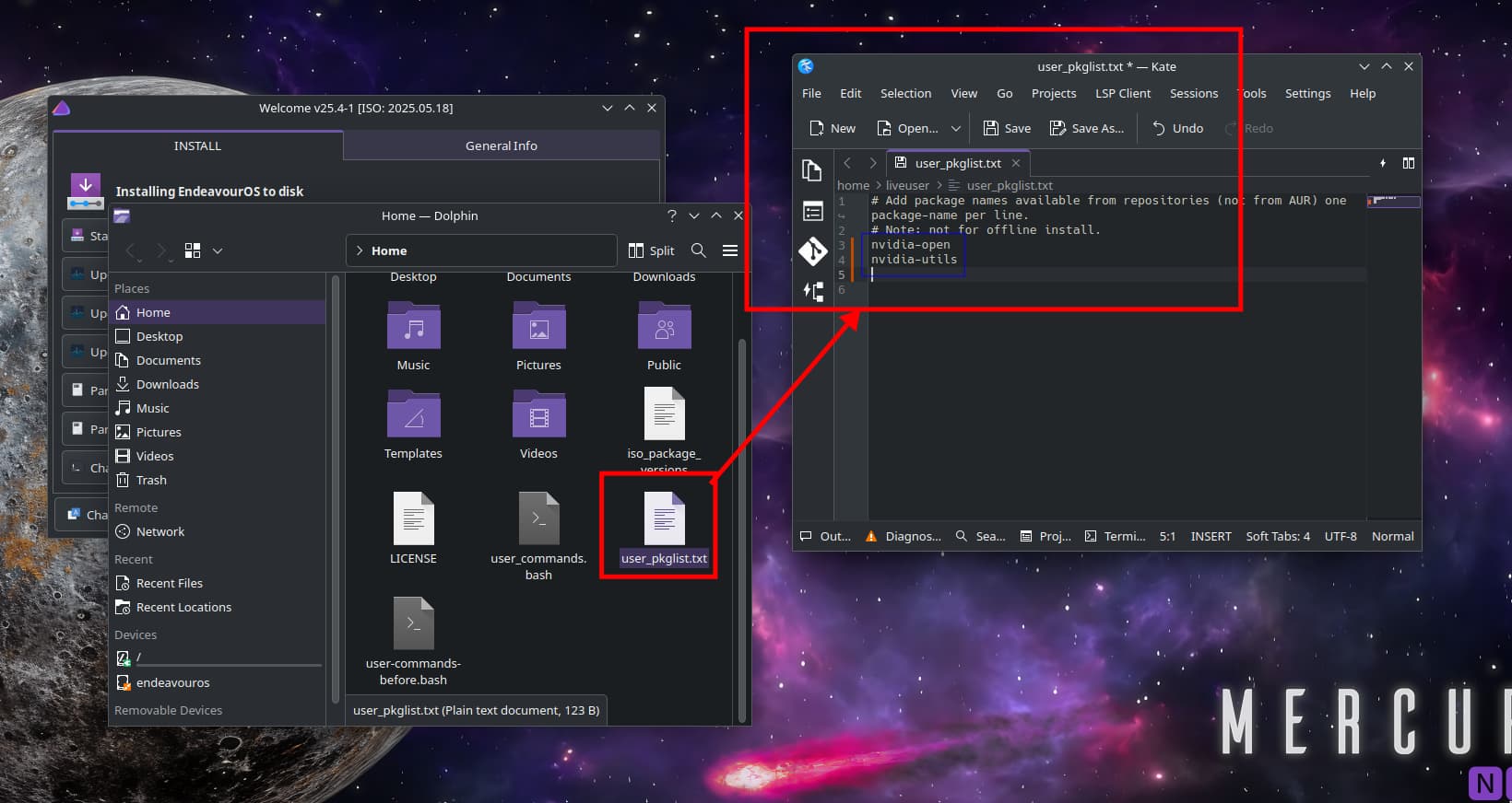

  1. before an installation in the environment (before the installer is started):
    Use the user_pkgfile implementation to manually add the necessary Nvidia packages to the installation:
  • learn more about this implementation here:
https://discovery.endeavouros.com/installation/customizing-the-endeavouros-install-process/2022/03/
  • Depending on the model of your Nvidia GPU you will need:
nvidia
nvidia-utils
  • or for the very latest GPUs (Nvidia)
nvidia-open
nvidia-utils
details: https://wiki.archlinux.org/title/NVIDIA#Installation
