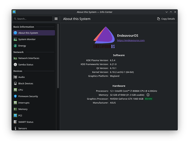

Works fine here with a GTX 1060.

Ok I did:
(As I already had nvidia-open-dkms after the last system update…)
yay -Rdd nvidia-open-dkms nvidia-utils nvidia-settings lib32-nvidia-utils
yay -S nvidia-580xx-dkms nvidia-580xx-utils nvidia-580xx-settings lib32-nvidia-580xx-utils
and verified the result with nvidia-smi after reboot and everything sems to work now.
Thank you.
