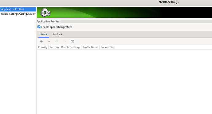

Hi i have updated my system and my nvidia drivers were gone, i reintalled them but then when i boot the boot loader (systemd) tells me that it failed to activate the nvidia persistent service and it shows no driver
Can someone help?
Ryzen 7 and nvidia geforce rtx 4060 gpu

still shows no nvidia card detected
