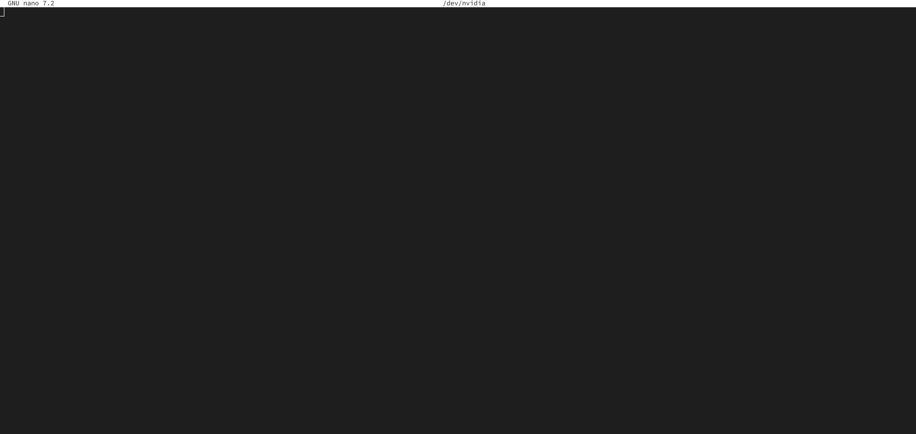

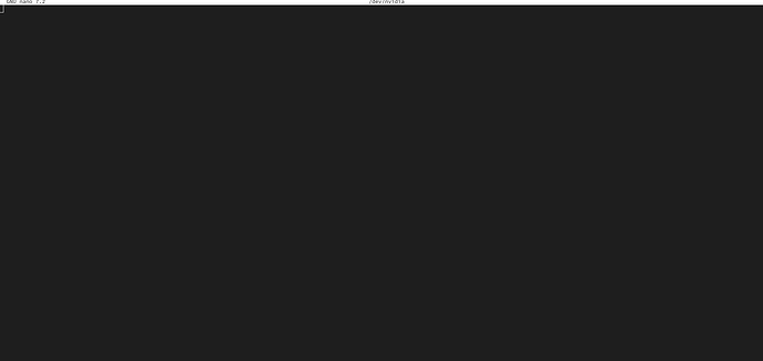

so what should i do now in the bootloder it shows no nvidia gpu detected
this file is empty
I guess there’s something wrong with the hardware.
