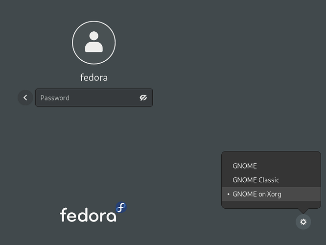

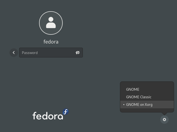

GDM is the Gnome Login Manager … where you start your Gnome session and you can change the session type from “Gnome” (default wayland) to “Gnome on Xorg” there before proceed to login. like this is showing:

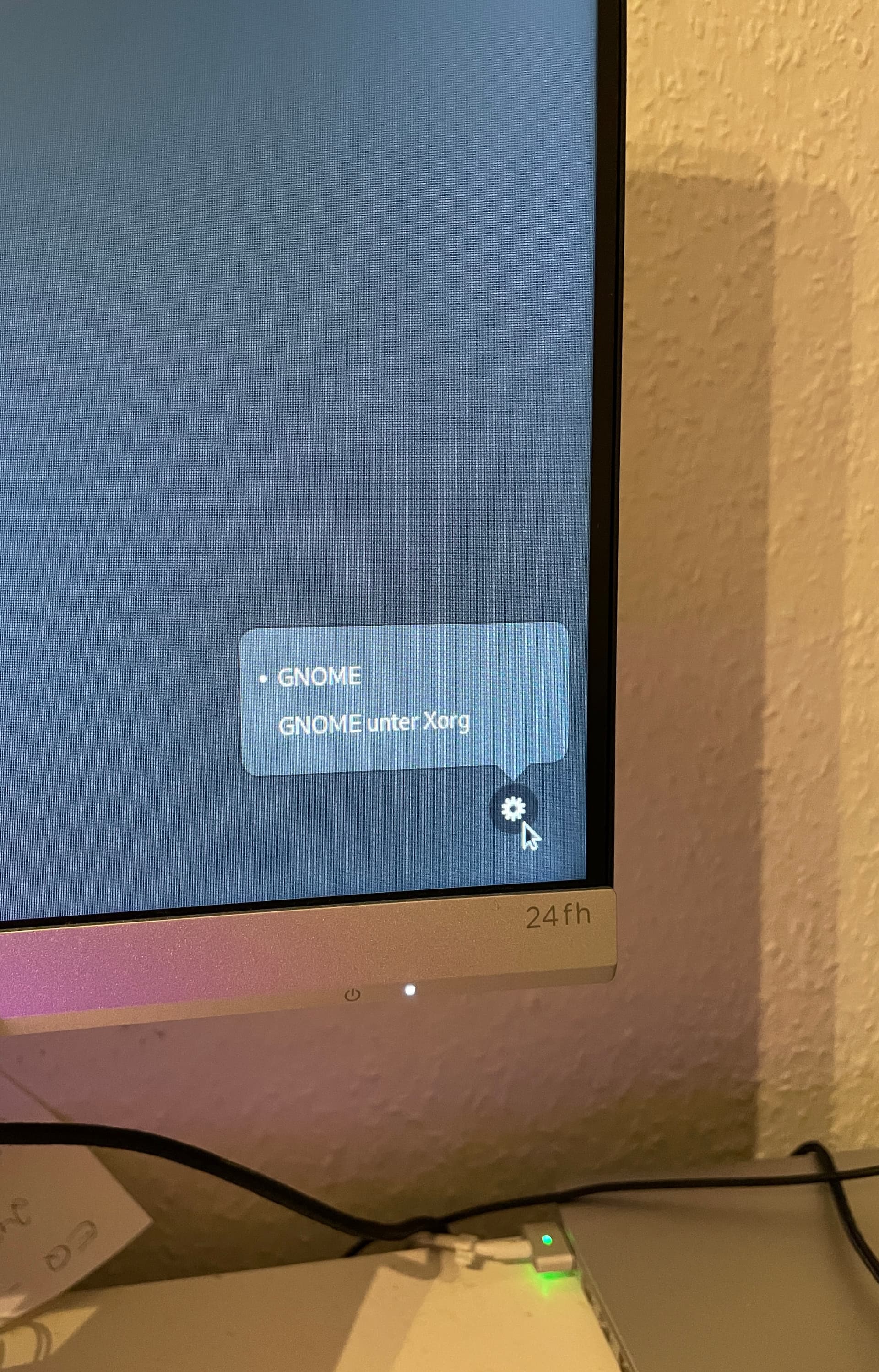

I think adding screenshots is way better.

So:
You see me installing EndeavourOS with Gnome. I didn’t change any settings there but I did start with Nvidia drivers. You see them successfully installed in the other screenshot. After installation and at the first start, the window manager suggests logging into Wayland. Afterwards, under settings, you see Wayland has been loaded.
So as you guys see my Nvidia graphics card has been installed (or do I have to dkms install it again at the first time booting) and the OS has boot into Wayland nevertheless.
I don’t understand - that’s not how it should work with Arch defaults. I guess the EnOS installer enables Wayland support? :thinking:
It seems like it does and it seems like the script which detects an installed nvidia gpu won’t switch to X11.
