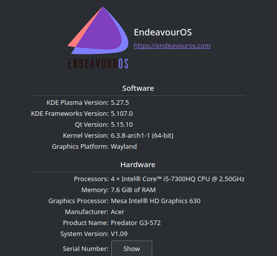

Hey, I just installed endeavour os and nvidia drivers. It works on x11 but not on wayland.
I followed the instructions from this forum: How to login to Wayland in EndeavourOS KDE?
but it still shows intel graphics on wayland rather than nvidia. I’d love some help please

[evirac@evirac ~]$ inxi -Ga
Graphics:
Device-1: Intel HD Graphics 630 vendor: Acer Incorporated ALI driver: i915
v: kernel arch: Gen-9.5 process: Intel 14nm built: 2016-20 ports:
active: eDP-1 empty: none bus-ID: 00:02.0 chip-ID: 8086:591b
class-ID: 0300
Device-2: NVIDIA GP107M [GeForce GTX 1050 Ti Mobile]
vendor: Acer Incorporated ALI driver: nvidia v: 535.54.03
alternate: nouveau,nvidia_drm non-free: 530.xx+
status: current (as of 2023-05) arch: Pascal code: GP10x
process: TSMC 16nm built: 2016-21 pcie: gen: 1 speed: 2.5 GT/s lanes: 16
link-max: gen: 3 speed: 8 GT/s ports: active: none empty: HDMI-A-1
bus-ID: 01:00.0 chip-ID: 10de:1c8c class-ID: 0300
Device-3: Chicony HD WebCam driver: uvcvideo type: USB rev: 2.0
speed: 480 Mb/s lanes: 1 mode: 2.0 bus-ID: 1-9:5 chip-ID: 04f2:b5f7
class-ID: 0e02
Display: wayland server: X.org v: 1.21.1.8 with: Xwayland v: 23.1.2
compositor: kwin_wayland driver: X: loaded: modesetting,nvidia dri: iris
gpu: i915,nvidia display-ID: 0
Monitor-1: eDP-1 res: 1920x1080 size: N/A modes: N/A
API: OpenGL v: 4.6 Mesa 23.1.2 renderer: Mesa Intel HD Graphics 630 (KBL
GT2) direct-render: Yes
no, I don’t think so. Bios looks very oldish and there are hardly any options besides boot sequence, secure boot and other simply stuff
