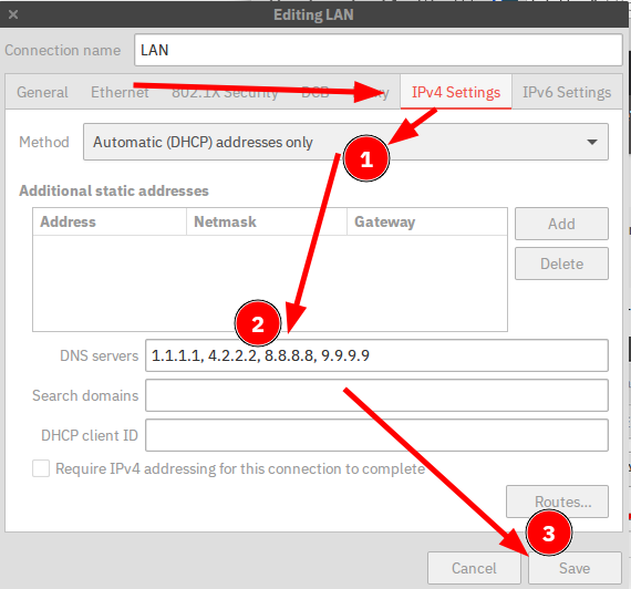

Depends on the DE, but you should be looking for something like this:
You can set the DNS resolvers manually and see if that helps (e.g. to 1.1.1.1 or 8.8.8.8 or 9.9.9.9 or another public DNS resolver).

If you pick a different option then you can set it to “Automatic (DHCP) addresses only” and make sure the working DNS resolver is the only one being used; otherwise the system will try to use non-working resolvers and fail.

Configure your connection to ignore the DHCP-provided DNS resolvers:
You can use one or more of those public DNS resolvers.
If the issue is being caused by Network Manager picking up the wrong DNS resolver then this will work around that problem. The next step would be to work out why you are being provided 192.168.1.0 in the first place.
