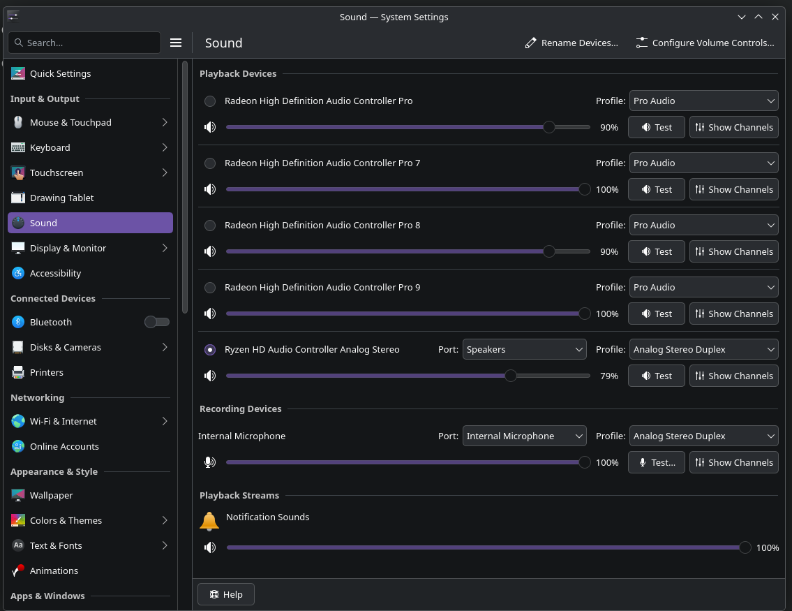

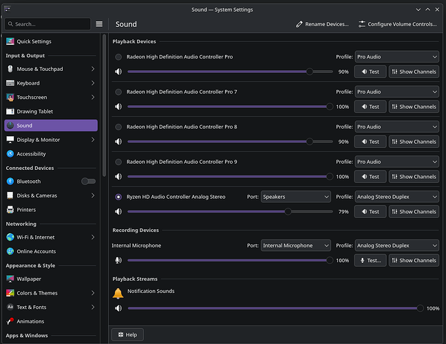

I’ve got a similar laptop (UM5606) and audio works fine. Here’s my settings for you to compare with yours. I’ve got speakers plugged into the headphone jack currently.

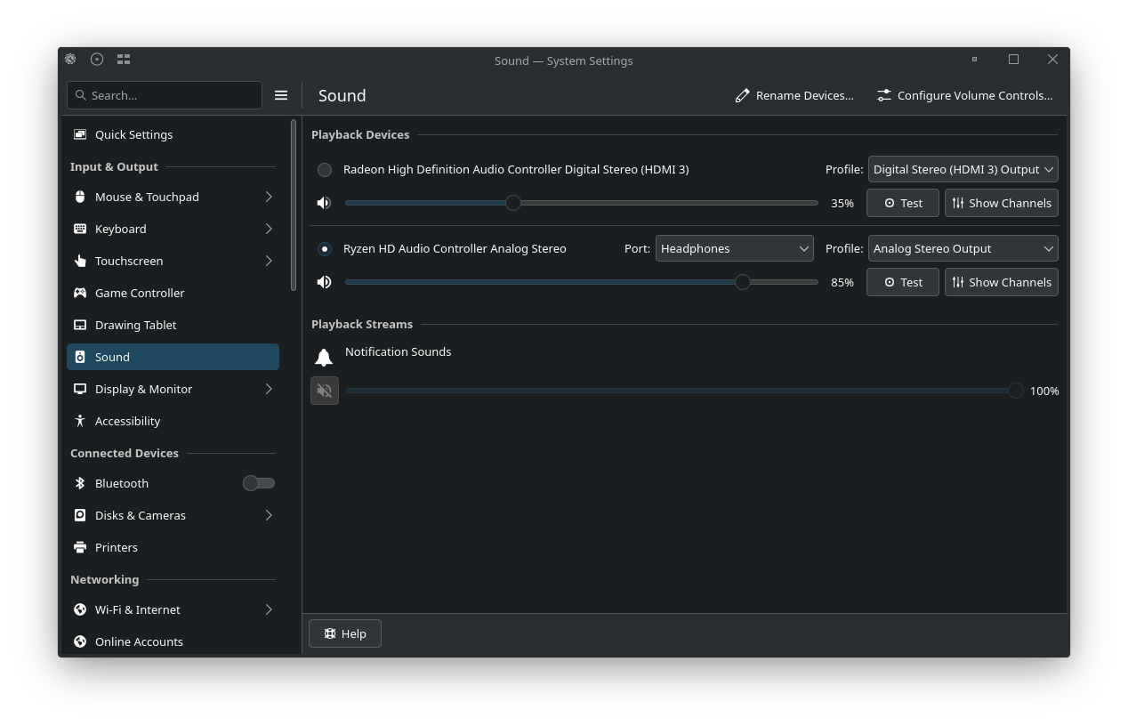

This is what I see.
To answer your question, I get no audio from the install USB using all the available options.
I have not tried using a Bluetooth headset yet.
I am resubmitting my logs since I just undid a change I made based on old advice. Undoing the change had no effect.
inxi = https://dpaste.com/H25XTZ89C
journalctl = https://dpaste.com/AYF3PTPPX

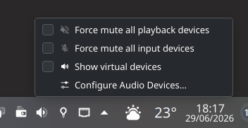

Do you get audio out if you plug in headphones/speakers to the 3.5mm audio output jack on the side?
Also, make sure you don’t have any devices muted. :wink:

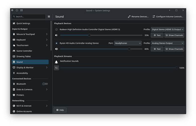

I went into alsamixer to make sure all connected devices were unmuted as part of my first pass through this issue, and have rechecked them several times.
I moved my aux plug to my soundbar from my desktop to the Zenbook. I am getting sound. I would rather use the available internal speakers, though.
OK, this is progress. If you’re getting sound out of the aux plug, then we know that the audio subsystem (hardware, drivers, etc.) is working…just not your speakers.
Does your laptop have the mute option on the F1 key like mine?
[Fn]+[F1] toggles mute.
