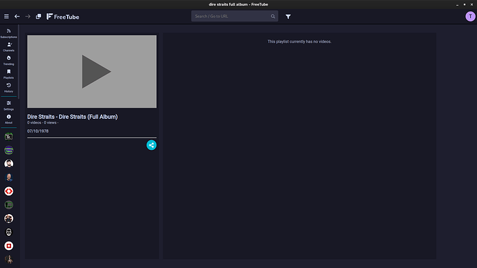

This playlist currently has no videos.
But it says the same on all the playlists I have tried so far.
Is It Just Me Or Everyone?
PS. Copying the YT link works.

If you search for Dire Straits full album for example, then you will see a few playlists for the songs on their albums. Clicking one of them should bring up the playlist but instead it says:

cactux
June 13, 2026, 12:01am
9
Top row, the second from left.

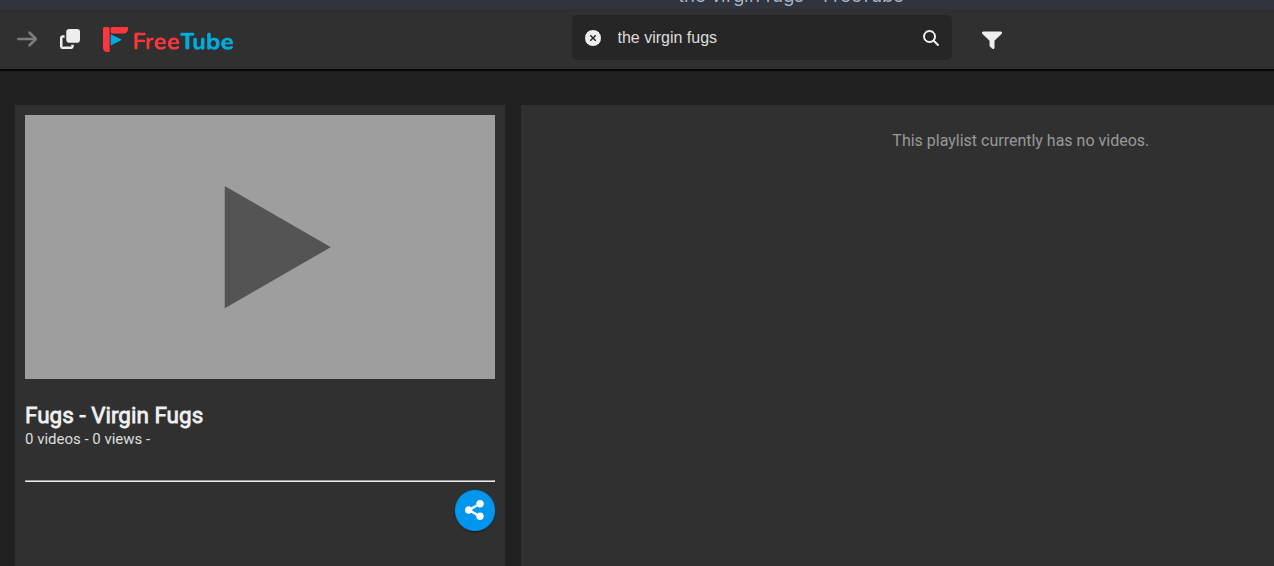

you have to click one of the play list videos. Maybe try the first kinks on the second row
first kinks, second row:
can confirm now.
**PSâI always thought of those as âwhole albumsâ not âplaylistsâ. now I know
EDIT, PSS: those sneaky bastar**
