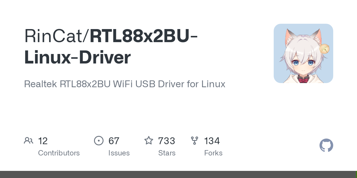

Maybe rtl88x2bu from the AUR as i see here. It is available in the AUR
Edit: https://aur.archlinux.org/packages/rtl88x2bu-dkms-git/
Thanks Rick. I had to reinstall the driver from the github repo you posted. That has it working again. Very odd that it stopped working overnight though as I hadn’t done anything out of the norm. Thanks again.

Well hopefully it keeps working as you get updates. It should as it is a dkms version so it should automatically build when you install a new kernel.
