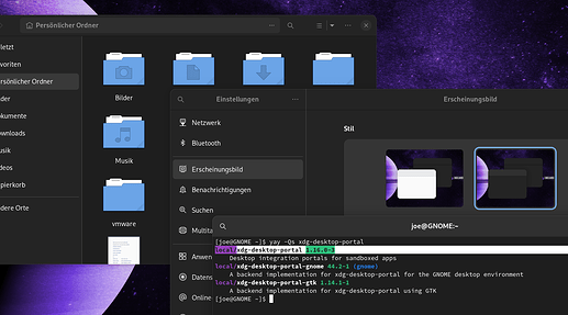

you need to choose one of the implementations fitting your Desktop Environment in addition to xdg-desktop-portal (base) package.
So choose gnome there… what will be 2
Or do it explicitly…
sudo pacman -S xdg-desktop-portal-gnome xdg-desktop-portal
This exactly 2 packages needs to be installed.
Danke @joekamprad , DAS hat geholfen! :wave:
