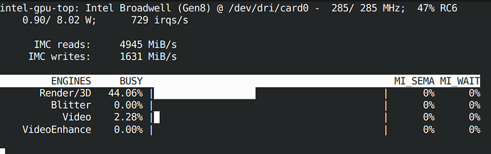

This is gpu_tools_top when I watch a video.
Usually when the video part is running the GPU should be enabled, it seems to me
