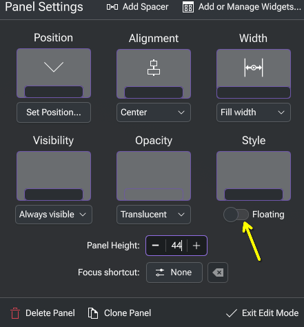

  2. Window sizing issues:
    “Floating panels” is enabled by default (may be theme specific), but can cause issues for Nvidia GPU’s. To disable it, right-click on your start-bar and Show Panel Configuration, and make sure the “Floating panels” slider is disabled. If enabled, it might even give you a warning about this issue!

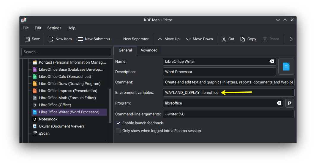

  3. LibreOffice scaling issues:
    The UI of LibreOffice might appear tiny or huge on different screens. This is a known issue when running multiple displays with different scaling settings. To fix this, add this as an environment variable for your LibreOffice shortcuts:
WAYLAND_DISPLAY=libreoffice
