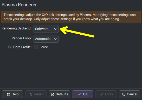

I changed Plasma’s Rendering Backend from “Automatic”, to “Software” and rebooted and bam, I now have loads of VRAM available for actual work. Plasma warns me that “Rendering may be degraded” because it’s in Software mode, but I’ve yet to see a difference.

I might switch back to “Automatic” rendering backend and run a few more tests. I’m referencing dozens of browser tabs at a time for what I’m working on in Blender.
This issue seems to at least be in part due to slideshow wallpapers. Everytime the wallpaper cycles, additional VRAM is consumed by plasmashell. Even after halving the wallpaper update frequency on both displays from 1 minute, to 2 minutes, plasmashell is still consuming a whopping 12GB of VRAM after just 4 hours. Nothing is freed up by closing all desktop applications.
