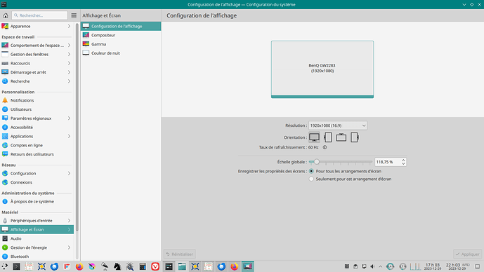

In your system configuration:
Take care :slight_smile:
