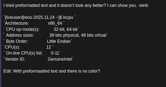

I tried preformatted text and it doesn’t look any better? I can show you. :wink:
[liveuser@eos-2025.11.24 ~]$ lscpu
Architecture: x86_64
CPU op-mode(s): 32-bit, 64-bit
Address sizes: 39 bits physical, 48 bits virtual
Byte Order: Little Endian
CPU(s): 12
On-line CPU(s) list: 0-11
Vendor ID: GenuineIntel
Edit: With preformaatted text and there is no color?

it use line by line codetags..

So i need to do it by individual line ?

no the complete blocj like before i have no clue how you get it doing this line by line tagging :wink:
When i try to set the complete block it doesn’t seem to work. Maybe I’m doing it wrong as I never ever used preformatted text button before.
