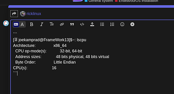

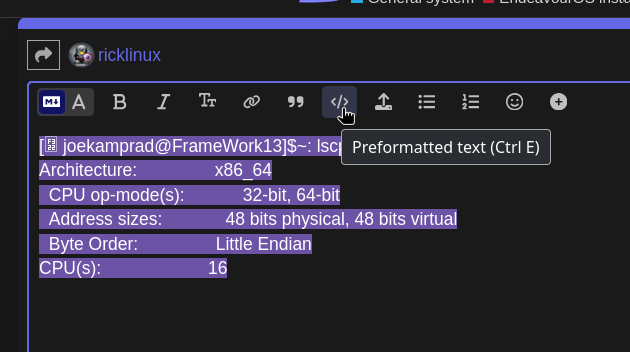

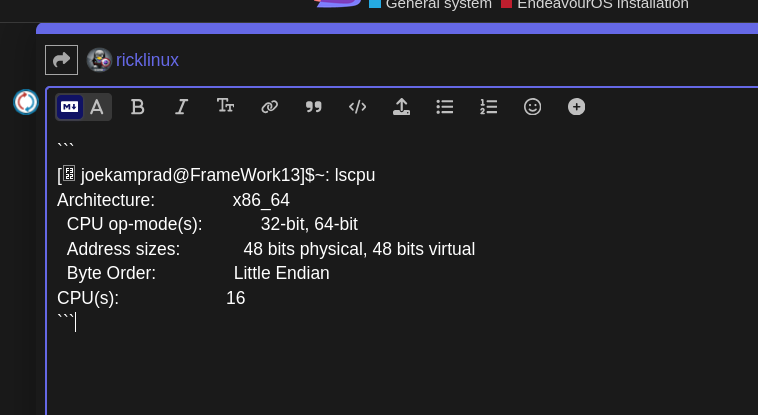

please use codetags for code its very hard to read as format gets screwed
Code tags don’t seem to be working.
inxi -Fxxc0z | eos-sendlog
https://discovery.endeavouros.com/forum-log-tool-options/how-to-include-systemlogs-in-your-post/2021/03/
is this from default boot or the nvidia boot option?
something changed on the forum software too i never saw these strange formatting:
in case you change format it gets screwed even more now :wink:
Yes…. something changed and I don’t know how to set it?
Edit: Before I always used three ~~~ tilde or three ``` back ticks?
Edit: Pre-formatted text also doesn’t work.
