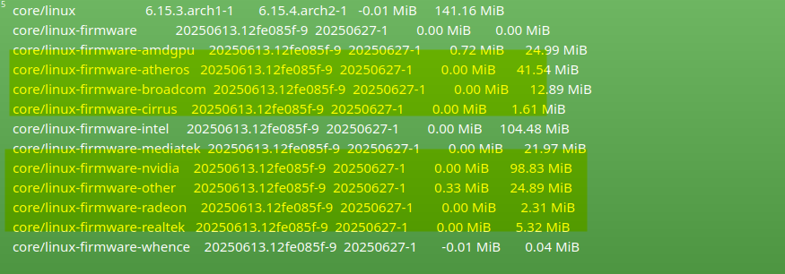

I’ve been OK so far with firmware updates, hoping there’s no issues with this one…
:crossed_fingers:
❯ up
[sudo] password for wombat:
 endeavouros                          15.4 KiB   167 KiB/s 00:00 [------------------------------------] 100%
 core                                116.5 KiB   597 KiB/s 00:00 [------------------------------------] 100%
 extra                                 7.9 MiB  24.3 MiB/s 00:00 [------------------------------------] 100%
 multilib                            134.7 KiB   691 KiB/s 00:00 [------------------------------------] 100%
:: Searching AUR for updates...
:: Searching databases for updates...
 -> Flagged Out Of Date AUR Packages: grayjay-bin
:: 29 packages to upgrade/install.
29  endeavouros/eos-bash-shared   25.6-1              -> 25.6.1-1
28  core/linux                    6.15.3.arch1-1      -> 6.15.4.arch2-1
27  core/linux-firmware           20250613.12fe085f-9 -> 20250627-1
26  core/linux-firmware-amdgpu    20250613.12fe085f-9 -> 20250627-1
25  core/linux-firmware-atheros   20250613.12fe085f-9 -> 20250627-1
24  core/linux-firmware-broadcom  20250613.12fe085f-9 -> 20250627-1
23  core/linux-firmware-cirrus    20250613.12fe085f-9 -> 20250627-1
22  core/linux-firmware-intel     20250613.12fe085f-9 -> 20250627-1
21  core/linux-firmware-mediatek  20250613.12fe085f-9 -> 20250627-1
20  core/linux-firmware-nvidia    20250613.12fe085f-9 -> 20250627-1
19  core/linux-firmware-other     20250613.12fe085f-9 -> 20250627-1
18  core/linux-firmware-radeon    20250613.12fe085f-9 -> 20250627-1
17  core/linux-firmware-realtek   20250613.12fe085f-9 -> 20250627-1
16  core/linux-firmware-whence    20250613.12fe085f-9 -> 20250627-1
15  core/linux-headers            6.15.3.arch1-1      -> 6.15.4.arch2-1
14  extra/alsa-card-profiles      1:1.4.5-1           -> 1:1.4.6-1
13  extra/gst-plugin-pipewire     1:1.4.5-1           -> 1:1.4.6-1
12  extra/libpipewire             1:1.4.5-1           -> 1:1.4.6-1
11  extra/linux-zen               6.15.3.zen1-1       -> 6.15.4.zen2-1
10  extra/linux-zen-headers       6.15.3.zen1-1       -> 6.15.4.zen2-1
 9  extra/pipewire                1:1.4.5-1           -> 1:1.4.6-1
 8  extra/pipewire-alsa           1:1.4.5-1           -> 1:1.4.6-1
 7  extra/pipewire-audio          1:1.4.5-1           -> 1:1.4.6-1
 6  extra/pipewire-jack           1:1.4.5-1           -> 1:1.4.6-1
 5  extra/pipewire-pulse          1:1.4.5-1           -> 1:1.4.6-1
 4  extra/rust                    1:1.87.0-2          -> 1:1.88.0-1
 3  extra/rust-src                1:1.87.0-2          -> 1:1.88.0-1
 2  multilib/lib32-libpipewire    1:1.4.5-1           -> 1:1.4.6-1
 1  multilib/lib32-pipewire       1:1.4.5-1           -> 1:1.4.6-1
==> Packages to exclude: (eg: "1 2 3", "1-3", "^4" or repo name)
 -> Excluding packages may cause partial upgrades and break systems
EDIT: All is well.
x

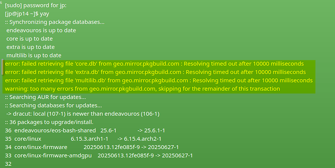

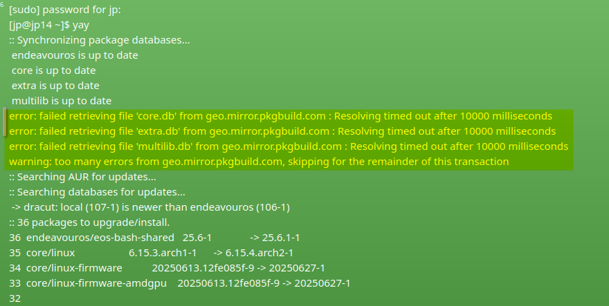

ok ever since i did this update , i don’t like what i see when running yay.
and why is all this updating? i don’t need it ? it’ taking forever
i never had mirror list errors before , nor did all that firmware update
The last week has been a mess of firmware updates and changes. Hopefully Arch Linux has its stuff together (for the moment)? Btw, firmware is definitely a needed component. Better to have updates that correct issues then no updates, right? Also, mirror errors have nothing to do specifically with Arch pushing out firmware updates.
Same here, lots of updates today. The firmware and Pipewire updates went without a hitch for me too. :vulcan_salute:
