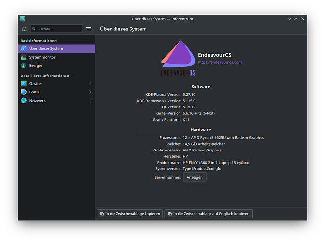

Thank you. The LTS-kernel shouldn’t be an issue or potential conflict, right? That was I mistake during the installation, because I’ve read that it will install an additional (backup)kernel, which is only used in an emergency, but is not normally inactive.
No you can install multiple kernels and configure your bootloader to see all of them, normally for a kernels a fallback image is created so that you can have backup to boot from in case the normal one doesn’t work. One of the reasons why it’s recommended to also have the lts kernel installed, for if all else fails.
That sounds reasonable, thanks. I’m just wondering why the lts-kernel is running by default and not the normal one?
Because it’s configured that way to be the default kernel to boot, on your system that is.
Thanks for pointing this out. So the lts-kernel is the default kernel to boot after the installation, if this option has been selected, and everything else has to be changed or configured manually, if the lts-one is only to function as a backup kernel.
These images are created as a fall back for if the normal kernel doesn’t boot.
initramfs-linux-fallback.img
initramfs-linux-lts-fallback.img
These ones are the normal images for booting.
initramfs-linux.img
initramfs-linux.img
And the kernels.
vmlinuz-linux
vmlinuz-linux-lts
Many people just install the lts kernel in case they have a problem with the normal kernel, as a backup. See this topic.
I forgot to mention that looks something like this.
linux /kernels/vmlinuz-linux
initrd /kernels/initramfs-linux.img
initramfs-linux-fallback.img initramfs-linux-lts-fallback.imgThese ones are the normal images for booting.
initramfs-linux.img initramfs-linux.imgAnd the kernels.
vmlinuz-linux vmlinuz-linux-ltsMany people just install the lts kernel in case they have a problem with the normal kernel, as a backup. See this topic.
I see. So basically it would be better not to choose to lte-option during the Calamares-installation and manually install it afterwards as a backup. And thanks for the link - I’ve already found this topic, but didn’t have time to read it in detail. However, the article recommends to always use the lts-kernel as default, which is not an option at the moment due to the sound issue.
It doesn’t matter what you choose during installation, you can choose whatever you want. When installing a kernel “fallbackup” intintramfs images are generated so that if a kernel fails to boot you can try to boot the fallback image. That being the reason why it is advised to install the lts kernel as wel, in case both the normal image and fall back image fail to boot.
That’s just a general recommendation, of course that are use case exceptions where that is not possible.
I have been following this and so i just decided to install the linux-next-git and linux-next-git-headers. Just over 3 hrs and had no issues using yay.
The new linux-next installation just finished after a little less than 3 hours, but it didn’t work again (kernel is still the old lts one).
There were a lot of warning messages for the headers though: Could not determine/find file information:

[atman@kali ~]$ uname -a
Linux kali 6.6.16-1-lts #1 SMP PREEMPT_DYNAMIC Mon, 05 Feb 2024 21:20:21 +0000 x86_64 GNU/Linux
What bootloader are using on your system, systemd-boot or Grub?
Grub
You need to generate your grub config if you installed a new kernel.
https://wiki.archlinux.org/title/GRUB#Generated_grub.cfg
grub-mkconfig -o /boot/grub/grub.cfg
This command did the trick and the sound is working now. Hooray!
Thank you so much for all your support and help. You guys are awesome ![]()
