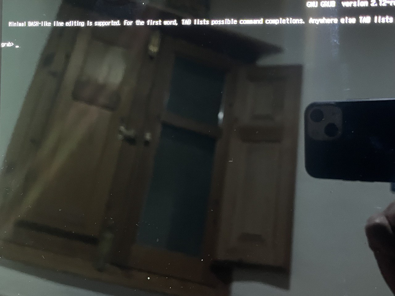

After the restart, the normal grub menu does not appear, but an input field (see photo). It is also no longer possible to start a live USB stick. Do you have any idea why this might be or how to get to the normal start menu? Exit works as a command to get to the normal selection, but the USB stick still won’t start.

Did you reboot your system after your root filesystem became full after trying to build that kernel from that PKBBUILD?

It already looks like this since EndeavourOS is installed, but the problem is that booting from the live USB stick no longer works.
Do you mean when booting from the usb you get that grub prompt and that when you don’t boot from your live usb your system boots into your current installation?
