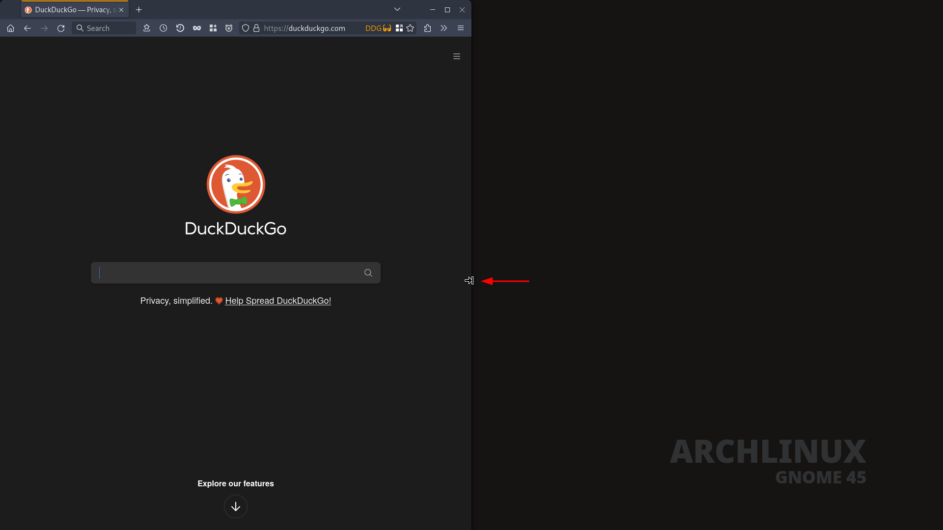

I thought I might pop in here to confirm if anyone else is unable to resize Firefox version 121 in a Wayland session in KDE Plasma after locking it to the left of right side of the screen.
Steps to reproduce:
  1. Sign into KDE Wayland Session.
  2. Upgrade from Firefox 120.0.1 (64 bit) to Firefox 121.0 in Arch Linux.
  3. Launch firefox.
  4. Use and left arrow to lock Firefox to the left side of the screen.
  5. Put mouse on edge\border of Firefox to open the re-size cursor.
Actual results:
  • In a KDE Wayland session, when Firefox is locked to the left or right side of the display no re-size cursor shows when putting the cursor on the border…
  • If you make Firefox free floating (no locked to left or right of the display) you will be able to see the cursor change to resize.
  • If you sign into Gnome 45 (Wayland Session) and lock Firefox to the left or right screen you are able to see the resize cursor.
  • If you sign into KDE (X11 Session) and lock Firefox to the left or right screen you are able to see the resize cursor.
Expected results:
If you sign into KDE (Wayland Session) and lock Firefox to the left or right screen you should be able to see the cursor change to resize mode and resize the size of Firefox.

I just tried to reproduce this on GNOME 45 Wayland.
It seems to be working fine so I wonder if it is not a KDE Plasma Wayland issue?

Hi Pebcak,
In the “Actual Results” section of the bug I also confirmed KDE X11, Gnome 45 Wayland / x11 resize in Firefox works correctly when locked to the left or right side of the screen.
I agree, seems to only affect Firefox 121 native install from Arch Repository(why i linked the Firefox bug). Firefox 120.01 native arch repo install resizes correctly.
