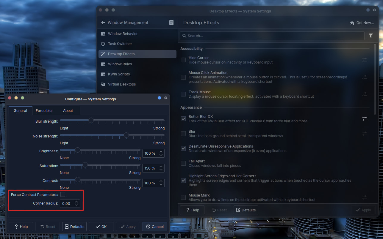

Have you adjusted the corner radius?
I think the fork version lack this feature.
Maybe this…
Though I did not notice any change.
It’s hard to see when you use same base color as wallpaper. Try with some contrast color wallpaper.

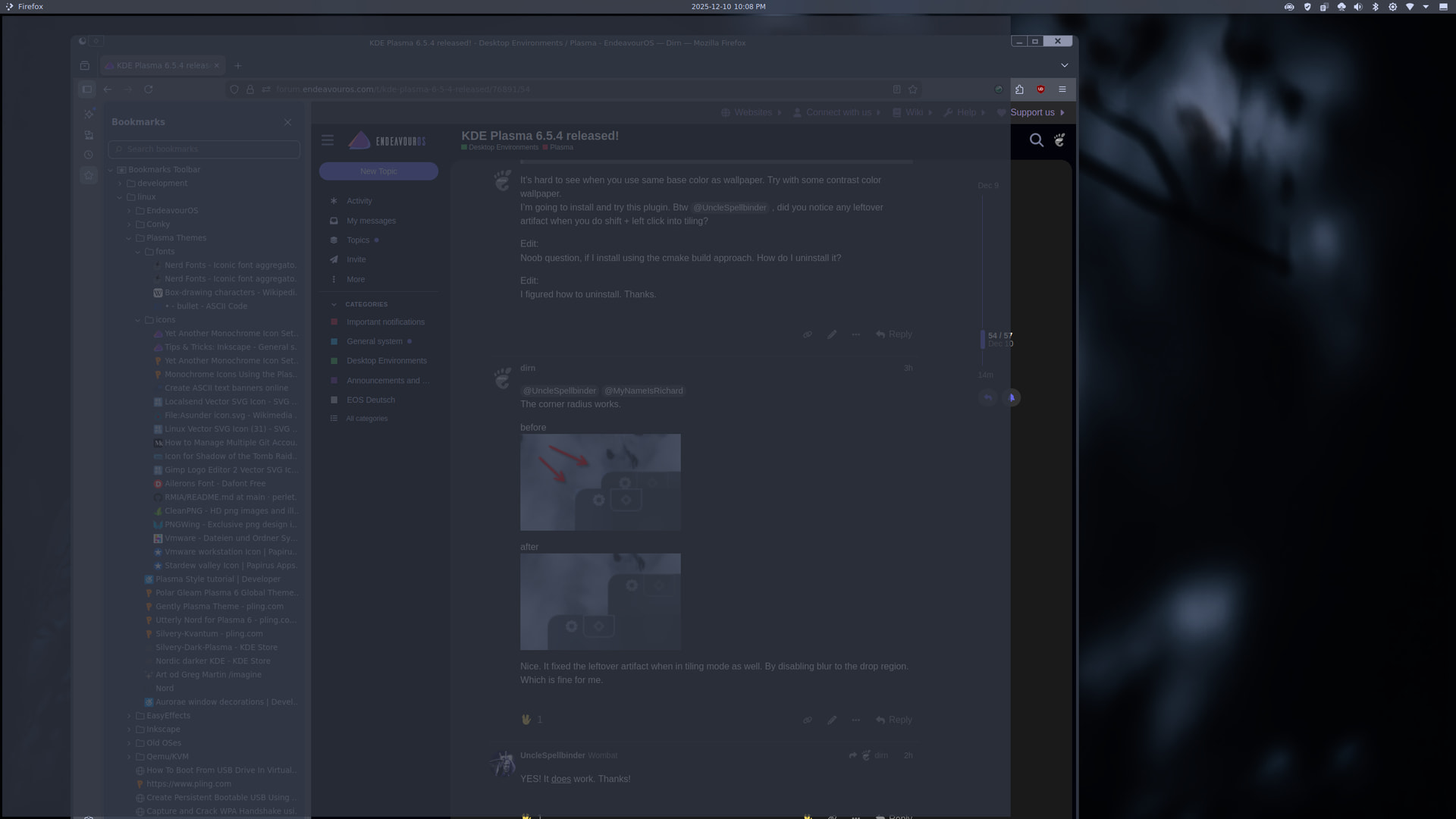

I’m going to install and try this plugin. Btw @UncleSpellbinder , did you notice any leftover artifact when you do shift + left click into tiling?

The corner radius works.
before
after
Nice. It fixed the leftover artifact when in tiling mode as well. By disabling blur to the drop region. Which is fine for me.
