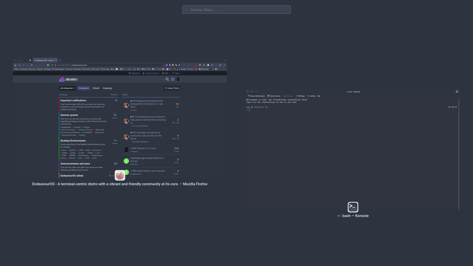

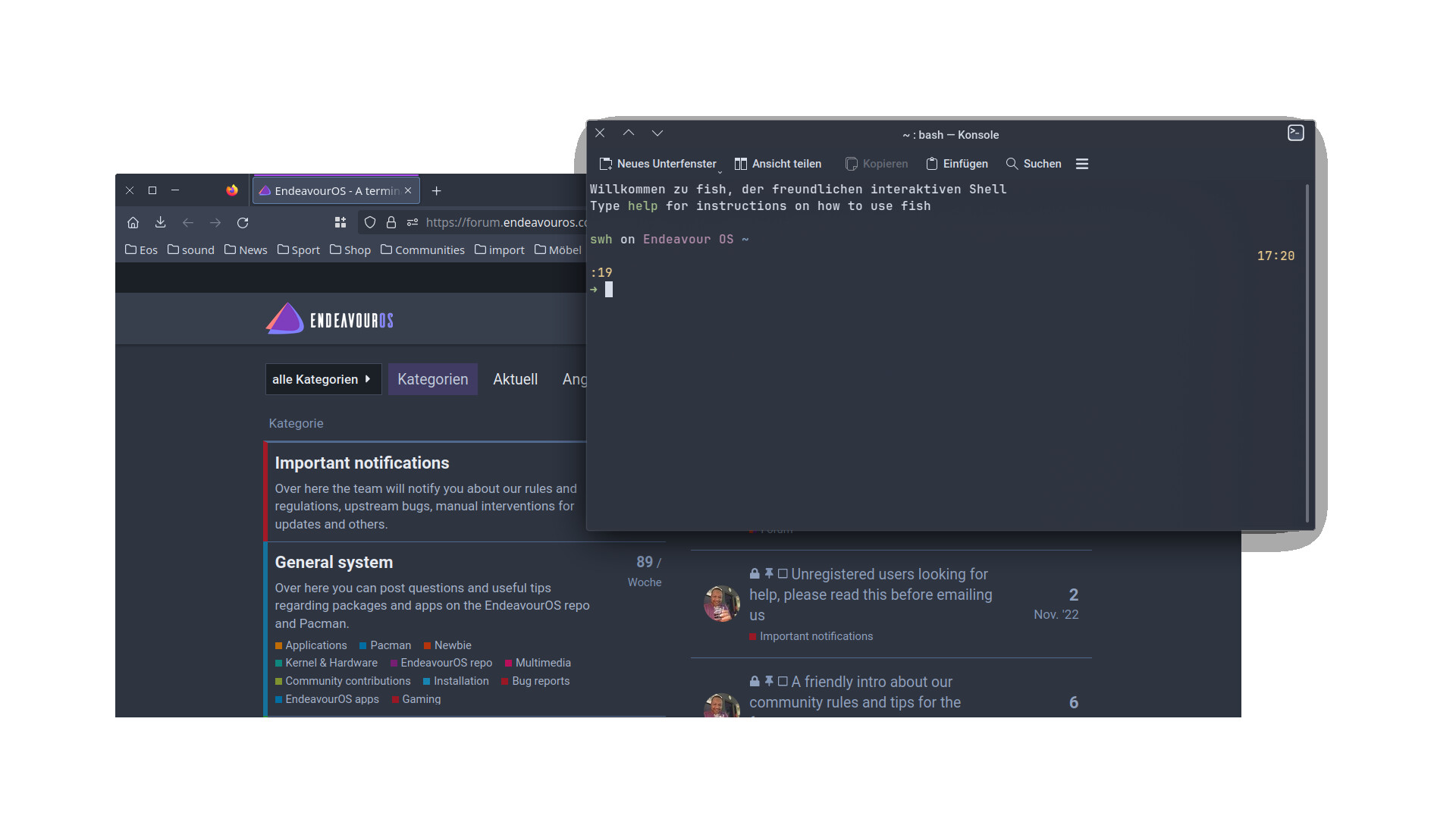

Is there any way to find out why plasma won’t start with my current configuration under Wayland?
Maybe just an extension which is buggy under Wayland or a theme. I am currently using Nordic Bluish
This is how it looks like when im on Wayland.
As you can see i have no background and no Panel at all.
I’m not an expert on logs, so wouldn’t know whether the answer is hiding in one of them.
I’m not so sure it would be a theme, but it could be an extension. My slow labourious process of doing it would to be to create a new user account, and slowly reconfigure it until it happened again (or not).
It might be worth asking the question at KDE Discuss to see if anyone there has an answer/explanation.
