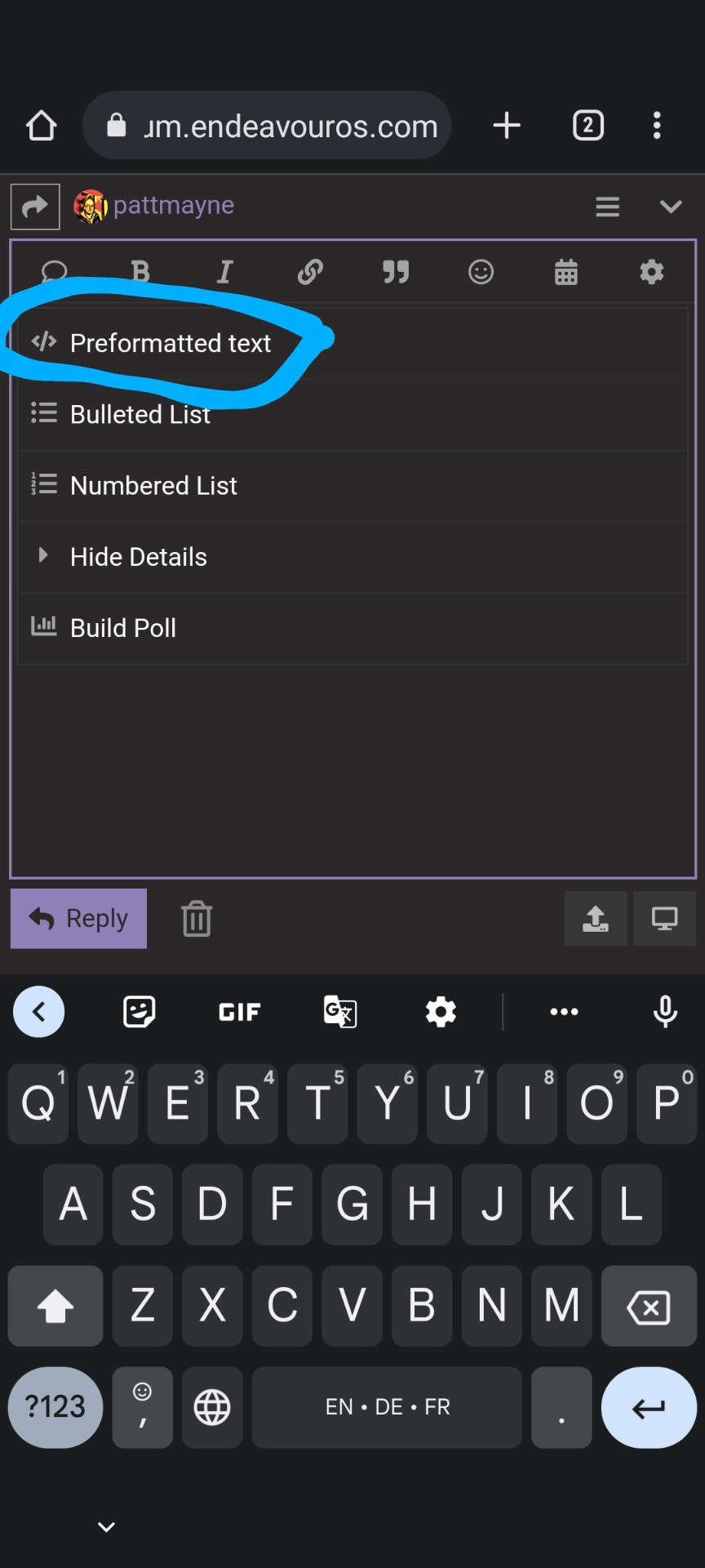

Try to wrap you code to make it more readable and syntax highlighted.
Highlight the codeblock and then select the right formatting tool like here (sorry on my phone):
Screenshot_20221024-204550
OK I did that, I think it looks better now.
