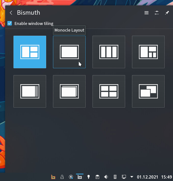

Can someone explain how this tiling works?
It says 3 - what it means? For example, pressing any Focus hotkey doesn’t bring different window in focus. But same Focus hotkeys work when I switch to Monocle layout
How to add 2nd windows on right?

From what i can see on the project git, they are implementing a gui applet to easily switch layouts but from the rate they are doing it, it will take one or two weeks. Using a tiling manager is all about mastering the hotkeys, im just waiting for the applet to start using it since i am going to only use the auto tiling feature & cant seem to master the hotkeys.
I use it and setup float (to float one window with meta+f) and to float the all windows with super+shift+spacebar. Those are the only two I really use all that much.

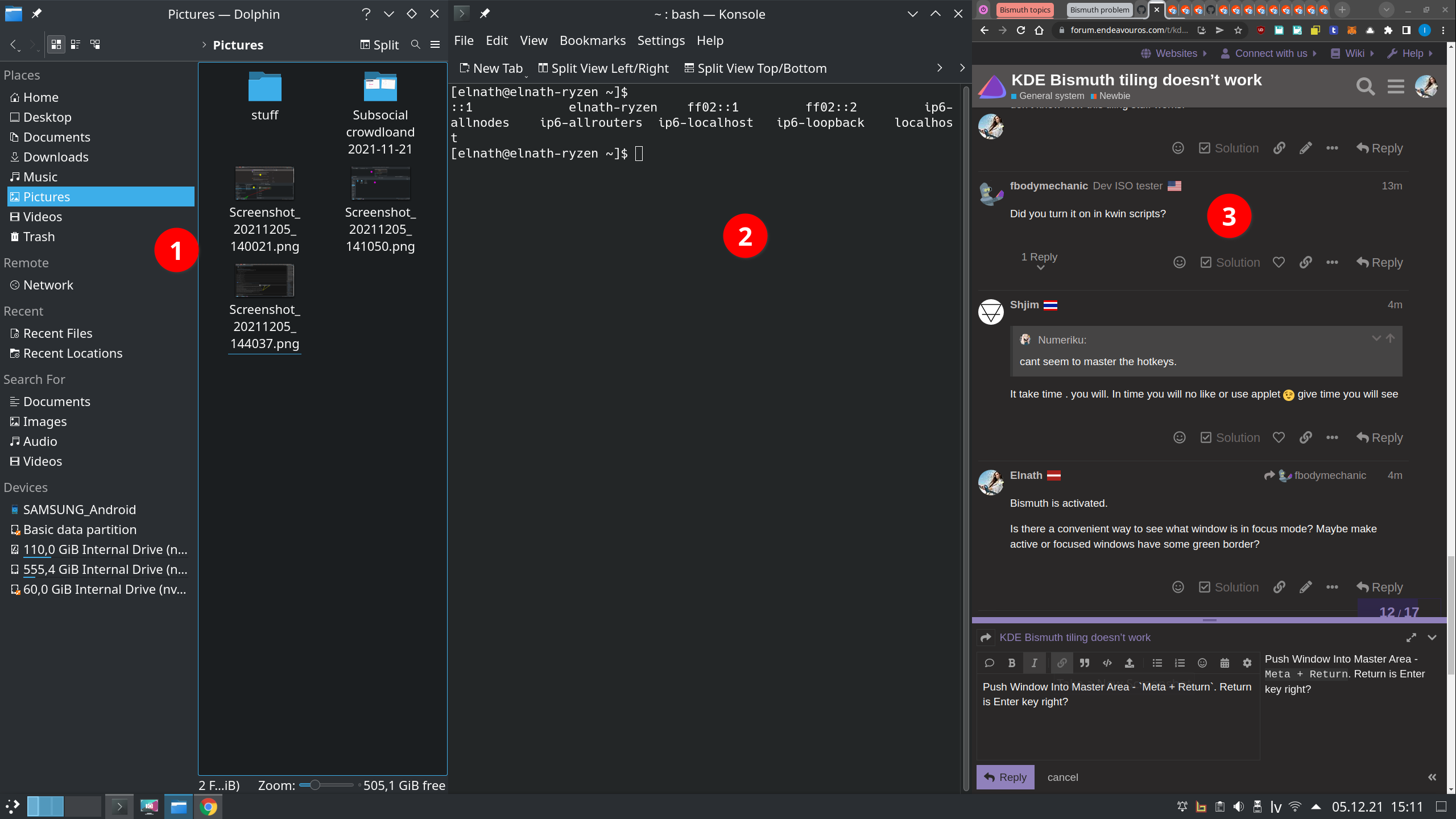

Is there a convenient way to see what window is in focus mode? Maybe make active or focused windows have some green border?
The titlebar shows up white for me. The out of focus windows are grey. Konsole is in focus.
You can also setup KDE to always have focus follow the mouse pointer. . .
Screenshot_20211205_051206
I on mobile atm… you can dim no focus windows or have border ( if it follow kronhkite) :pray:forgive spell
There is nothing like that for me. So its very hard to track which window is active (focus) mode.

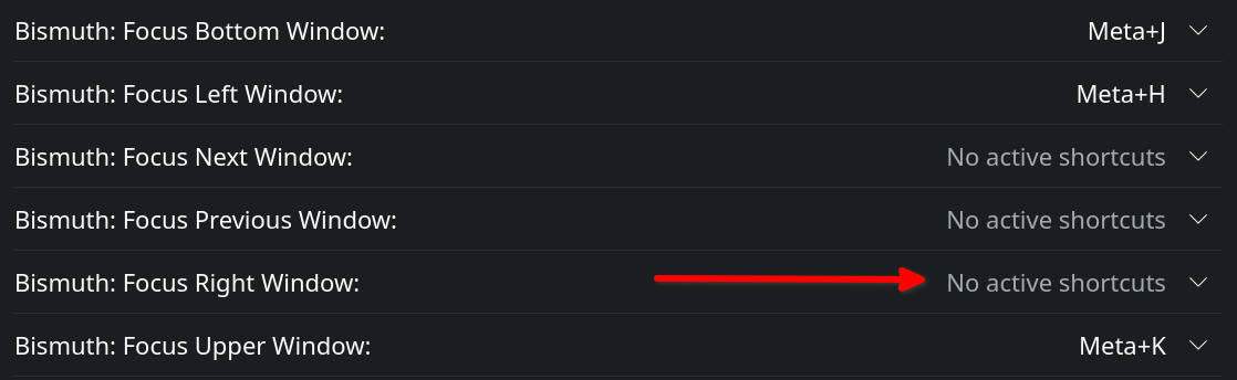

Pressing Meta + L doesn’t make active Window 2 or 3. ??
Edit1: Alright, I found something interesting seems like Meta + H works no problem, but Meta + L doesn’t work. (tested by making active window just with mouse and then Meta + H goes left, but Meta + L doesn’t go right) :thinking:
Just go through the shortcuts. Change them to whatever you want.
I would like to keep defaults for now. I don’t know what is blocking Meta + L
Edit 1: Nothing was. That hotkey was removed somehow. Very weird.
