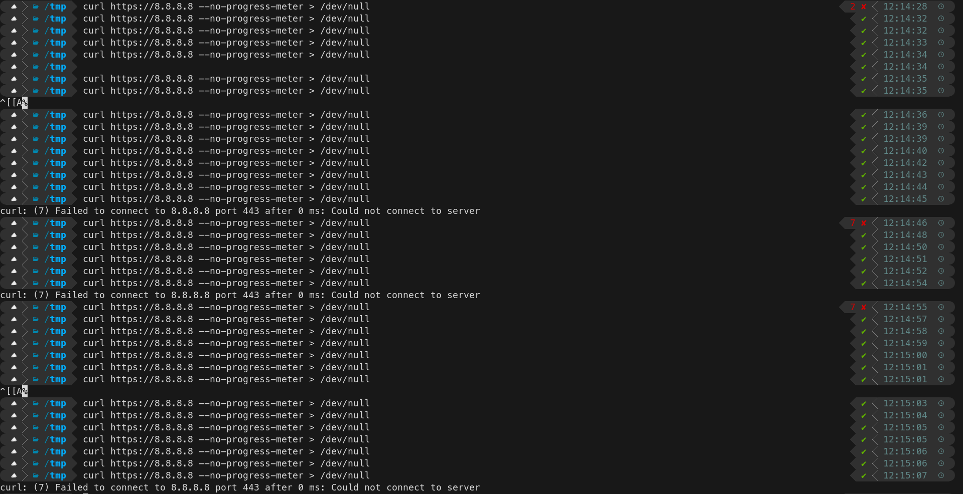

Hi, my internet seems unstable since a couple days. It was worked just fine for years. Maybe an update was responsible for it?
what I get:
  • websites randomly not loading
  • git clone (over ssh) randomly failing
  • happening regardless of what network I’m on
  • not a DNS issue
using thinkpad L13 yoga.
internet chip: Meteor Lake PCH CNVi WiFi
how to troubleshoot?

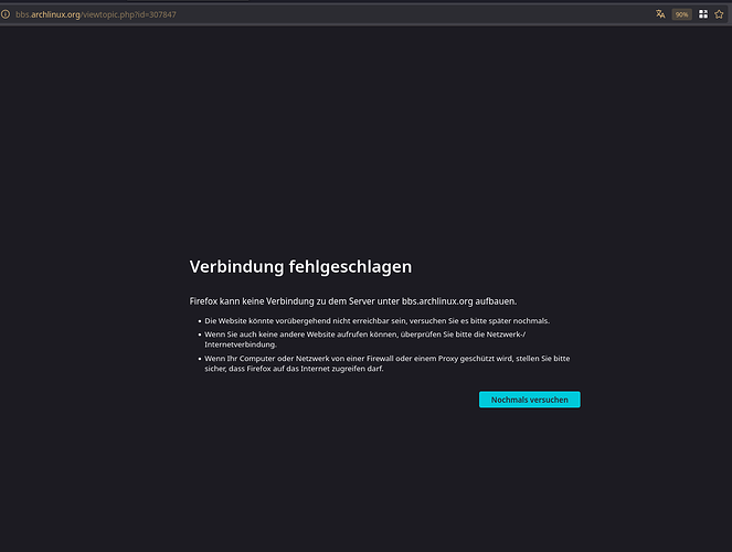

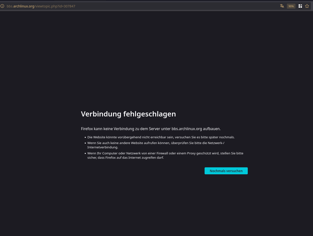

Looks similar:
Seemingly random connection errors - bbs.archlinux.org
Definitely, well for me anyway.
Well, I’ve just had my first “Unable to connect” error since I changed DNS providers a few days ago :frowning:
That looks similar to my symptoms too. I won’t downgrade the kernel unless it starts occurring too often.
