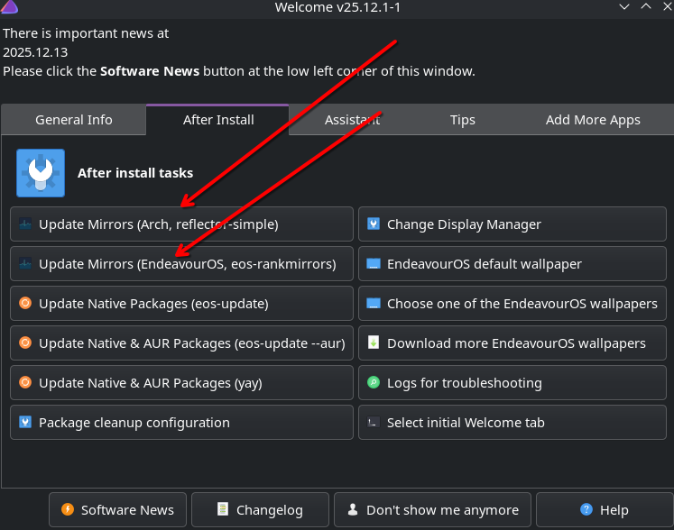

Have you made sure to update the mirrors?
How can I do that if I don’t have a working OS?
When you are running the live enviroment there is an option in the welcome part where you can share the logs

I know I mentioned it already but have you ranked the mirrors at all?
No because when I click on “Update mirrors” I get
reflector:Fetching information from https://www.archlinux.org failed
do you have an option to use rate-mirrors? that may work
I don’t see that option anywhere.
