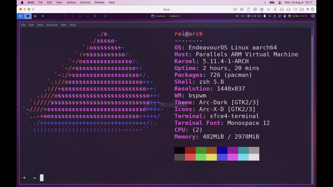

Install Arch /EndeavourOS VM on M1 Mac using parallels. Quite interesting.
Out of curiosity, how is this working for you.
Pudge
I’ve only had it up and running for a few hours and I’m very much a novice with desktop linux (Some familiarity with “server” linux, usually I’m working with teams that have dedicated ops/network engineers. This is a learning experience :slight_smile:). So I’m probably not the most qualified to say, but so far I haven’t noticed anything odd.
I think for anyone wanting to try out linux on arm (maybe to test/improve it), or to have it run some services locally like a DB server while doing development in macOS, it would be fine. (Although they may have a smoother experience on a distro that parallels “officially” supports.) I was able to install/run their guest agent just fine in arch and endeavour.
